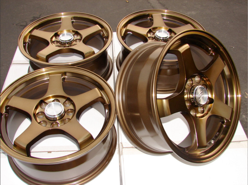

Wow, over 4 months since my last post. Bart hasn't been forgotten, just put on light duty. The R160 is beginning to complain and I've been too busy to attend to it. He gets driven around town, once a week or so, to keep keep the atrophy at bay.
In the meantime, Bart has some fresh bling awaiting (15x6.5)...
