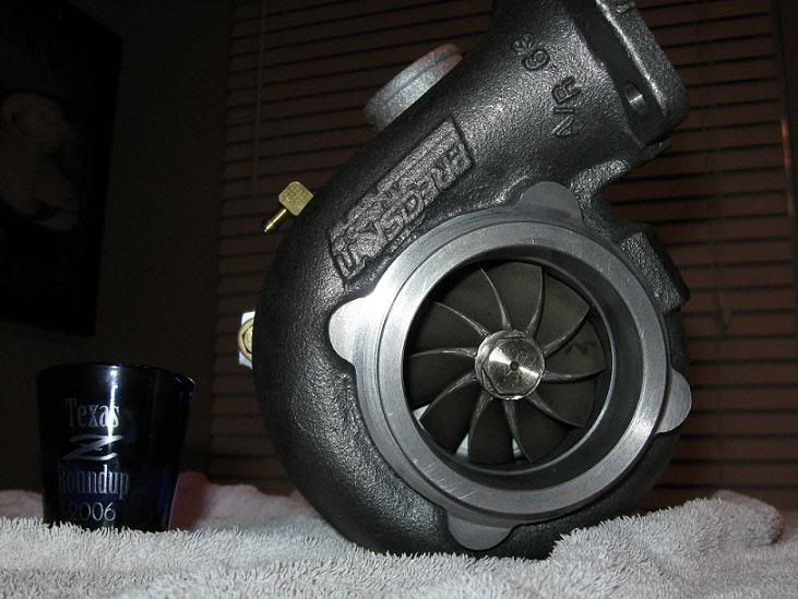

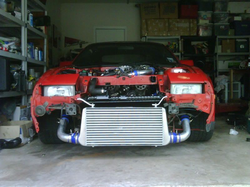

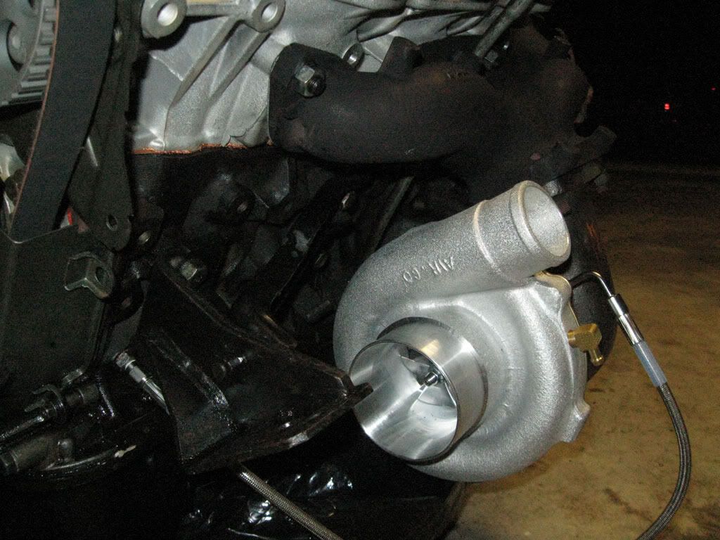

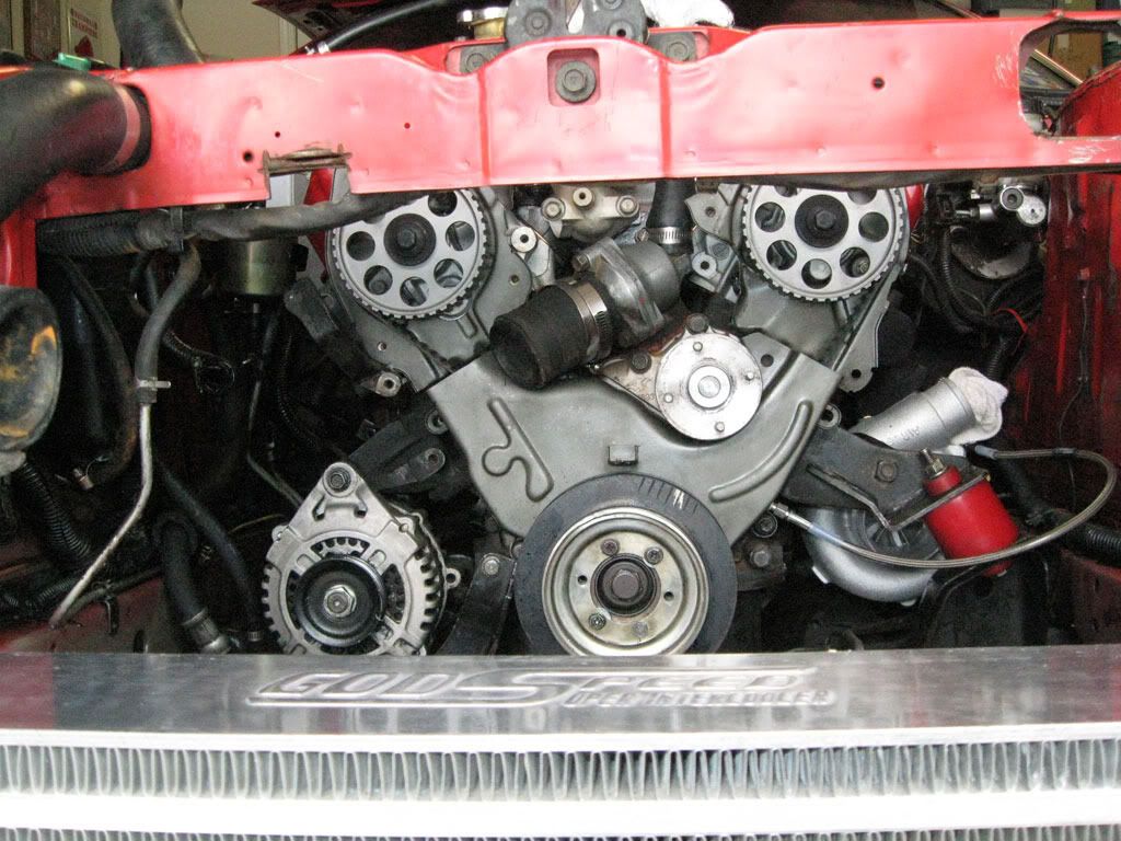

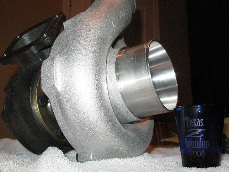

Got the Z running again yesterday. Had my tensioner let go while at Branson Z Fest back in June. Still needs a little more fine adjusting and tuning before I start to turn up the boost. But it should be ready to lay rubber @ 60 mph soon enough. ;)
I also changed things around some more. Upgraded my turbo a Precision Billet 62/62, changed out my intercooler setup, added a Tial 38mm wastegate, etc.

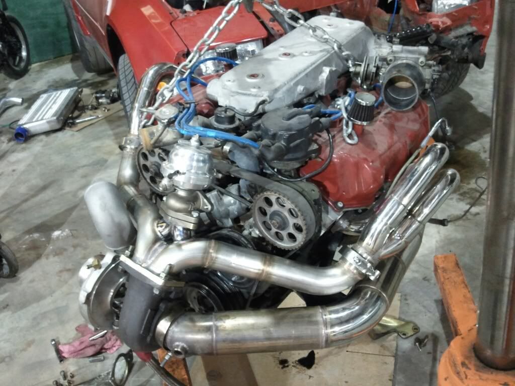

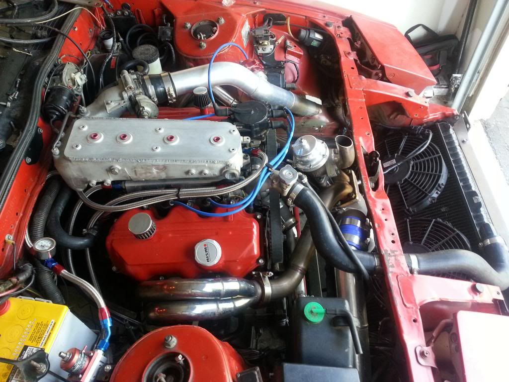

Had StreetFighter (2JZ Z31 300ZX) build me custom manifolds a couple years ago. Here's how it turned out:

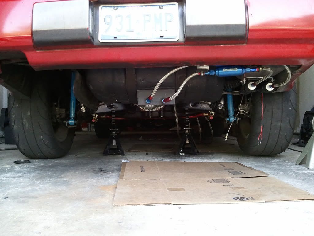

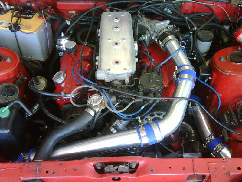

Installed all new fuel system:

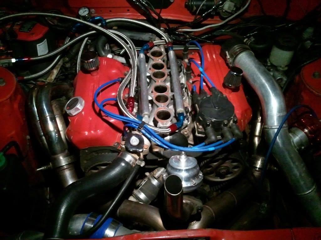

Took it to the dyno last Tuesday:
And so far it looks like I have the record for most power on a stock bottom end VG30.
545 RWHP and 540 RWTQ
