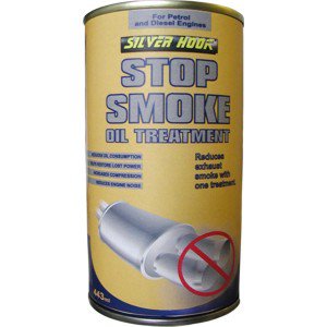

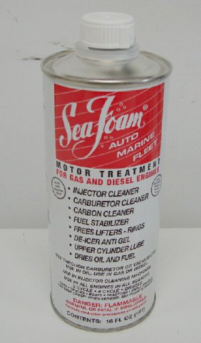

neotech84 Posted March 24, 2009 Share Posted March 24, 2009 Mybe this???? this might help as well...... just my .02 Quote Link to comment Share on other sites More sharing options...
