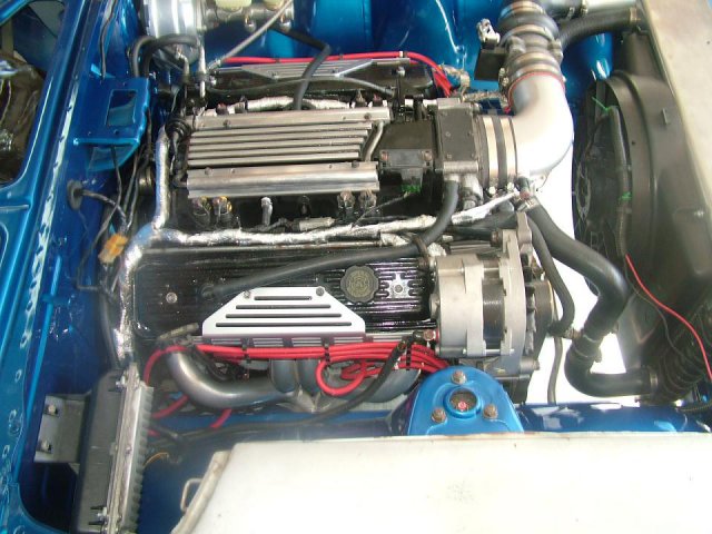

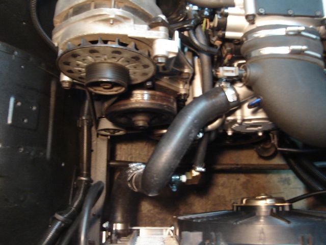

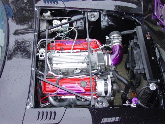

gvincent Posted April 16, 2009 Share Posted April 16, 2009 I brought a similar thread up a year ago and I think this thread enforces the top hose theory. Here was my thread from last year. http://forums.hybridz.org/showthread.php?t=134583 In that thread I have pics of my old set-up also. I was also looking through my engine photo collection of other members past LT1 installations and most of them used the lower hose like I did the first time. Some of you guys will recognize your photos. Curious that most of these probably worked ok??? If you see your pic let us know if you are still running this way I have a Griffin rad with a huge bottom connection so I guess I will have to spend some time at NAPA searching for hoses that will fit the bottom () Thanks, Greg Quote Link to comment Share on other sites More sharing options...

gvincent Posted April 21, 2009 Share Posted April 21, 2009 Hey Mike, Do you have any pics of the hose splicers? According to all recent LT1 swaps the majority of the swaps have the vent tee on the top radiator hose now, Is JTR in agreement with this? Will I still have the cobbled looks of radiator/hose/reducer/hose/water pump and radiator/hose/reducer/hose/tee fitting/hose/water pump? There has got to be a cleaner way to do this. It looks like a rotor rooter tiller with all the hose clamps right now. Greg Quote Link to comment Share on other sites More sharing options...
