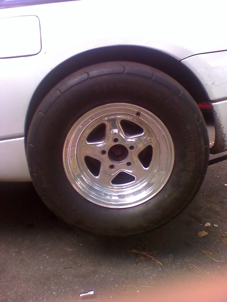

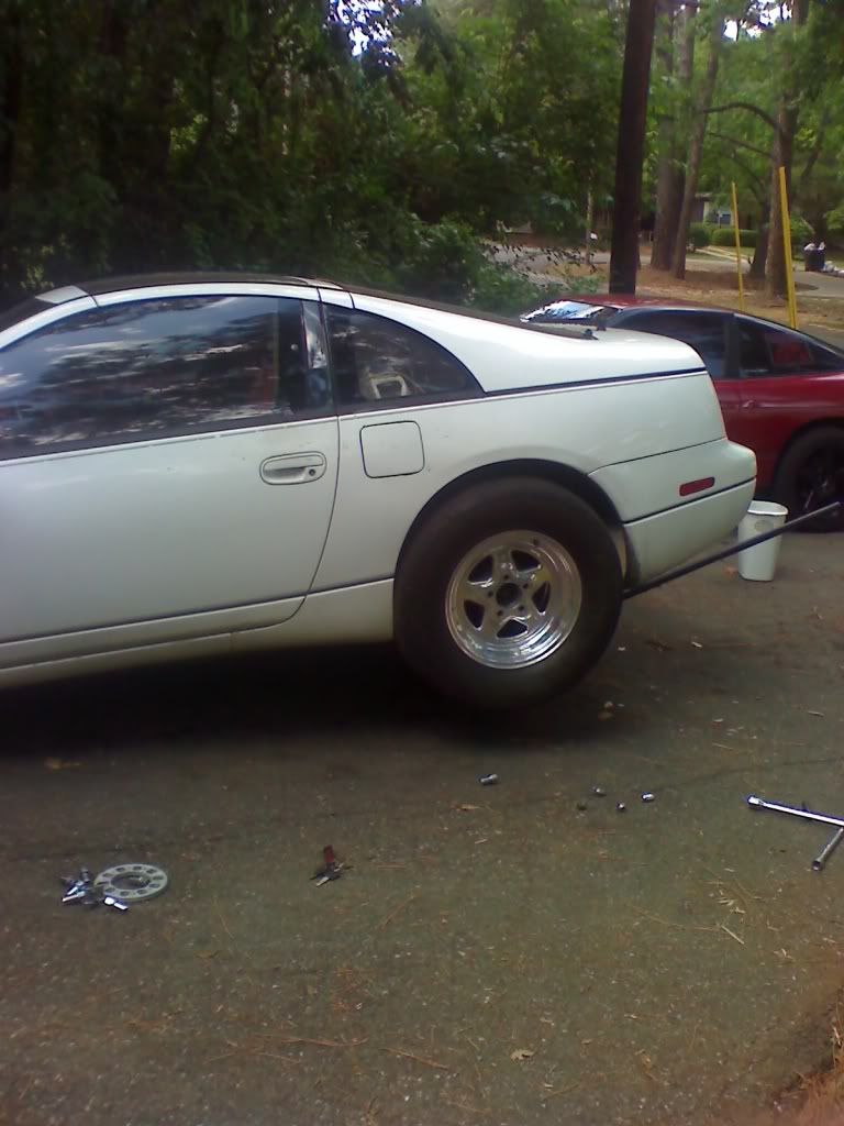

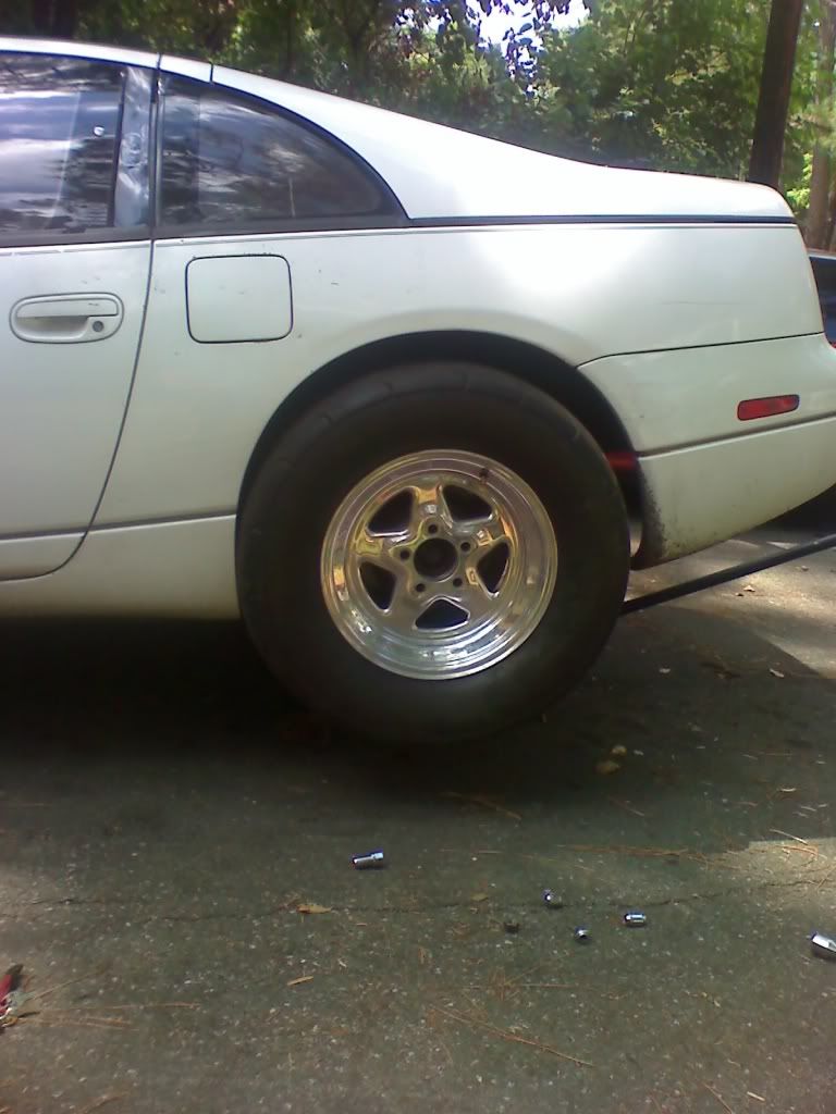

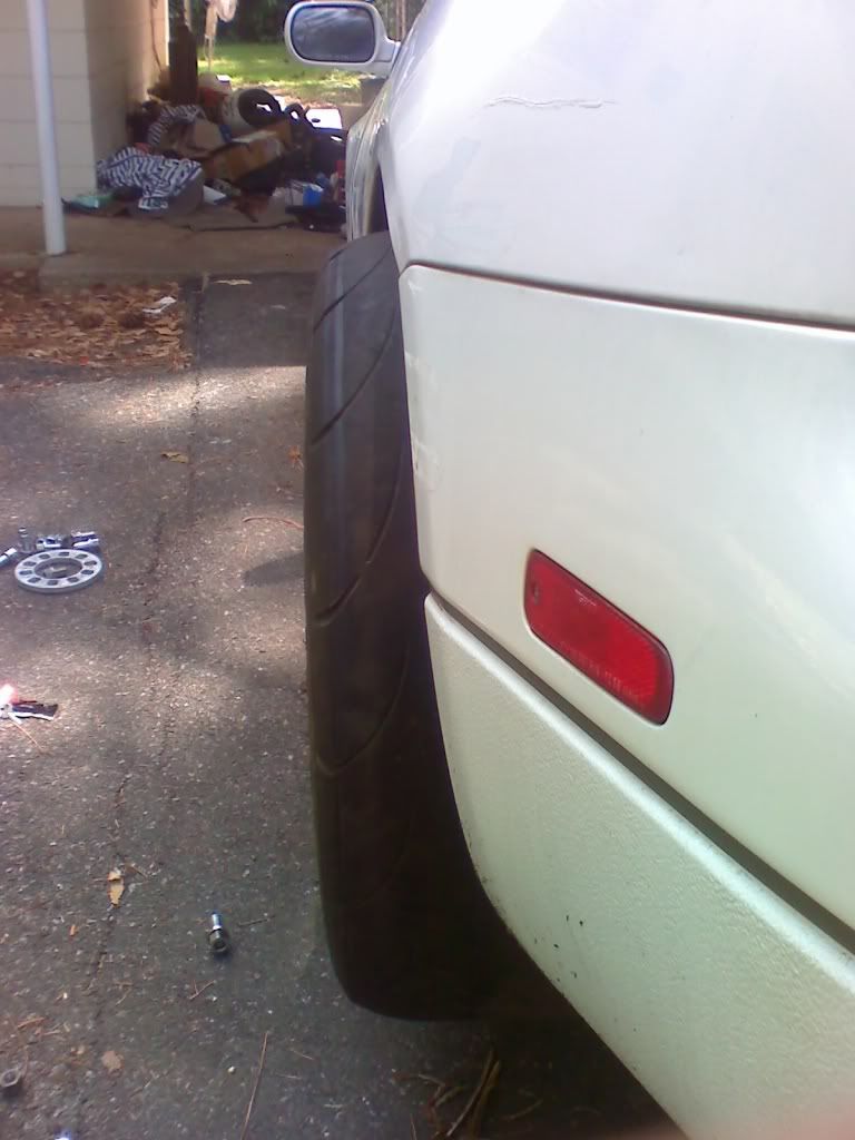

fsuz32 Posted May 3, 2009 Author Share Posted May 3, 2009 looks good man thats a sweet car, ... figured i'd update again, I think I found the wheels im going with on the rear, they are 15x8 prostar's w 5.5" bs and a 15mm spacer.. they are my buddys and came with 28" tall tires so i figure'd i'd see how they fit... it's a no go lol the pro stars fit though, so i think i am just going to run 26 or 27" slicks on them, i'm thinking 27x11x15. The only thing that concerns me, is they stick out slightly more than i think i'd like..but i'm getting them for a pretty good price. what do you guys think, they arn't bolted down and in the air, once it's lowered I think they will tuck a lil more. I also plan on flaring my fenders. Quote Link to comment Share on other sites More sharing options...
