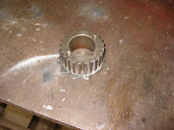

He's using LS2/truck coils and he has modified his stock crank sensor wheel so it's a 12-1 wheel for the stock 2JZ crank sensor to read - he just cut off one of the 12 teeth. I was planning on using the stock crank sensor and the rear cam sensor for TDC per Speeder's note in another thread. Apparently the 12-1 is accurate enough for this guy and I think he's shooting for ~500HP, though I don't recall.

Stock tooth-count is 12 on the Toyota crank sprocket. The 2JZGTE uses two cam angle sensors in addition to the crank sensor.
can you use 3 of those plates and stagger them, and then cut the tooth off one?

The plate I believe you're referring to is part of the crank sprocket, which needs to be aligned for the timing belt. Not a bad idea, but I'd have to do a lot more work than I'm willing to do what I think you're suggesting.
