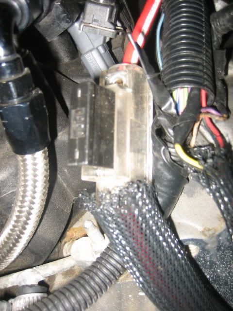

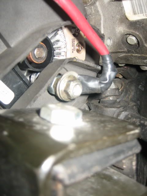

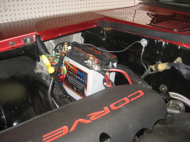

I havnt destoryed an alternator since this thread. But its still in the back of my mind cause I didnt really change much. Here are pictures of how everything is hooked up. Maybe someone will see something obvious?
Excuse the mess. Some wiring changes were happening when the pictures were changing and the car had been sitting a while.
