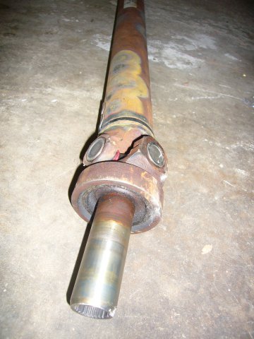

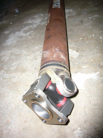

chris51881 Posted March 15, 2011 Share Posted March 15, 2011 I had my driveshaft made yesterday. I got a full t56 driveshaft on ebay because I didn't feel like dealing with picking the right yokes. I was going to have the end cut off of the Nissan shaft and attached to GM shaft but the Nissan shaft diameter is 5mm wider than the GM shaft. We ended up putting a new Spicer flange on the end and it worked out great. Anybody in the Rochester/Syracuse NY area, I suggest contacting Vic at Ontario Engine & Machine: http://www.ontarioengine.com/ They do all kinds of engine/drivetrain work, good guy too. I guess there isn't much to say until I give it a few trial runs... This weekend I'll be doing more so look for updates in a few days. Quote Link to comment Share on other sites More sharing options...

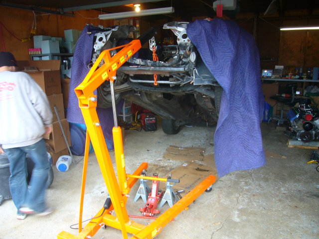

chris51881 Posted March 22, 2011 Share Posted March 22, 2011 Here's the poor man's lift... We started working on the trans tunnel. Didn't get far enough for any good pics. I have all of my pieces ready for the transmission mount. I'm going to try to get a MIG welder next time instead of the Home Depot flux core style rental unit. $1000 to have my truck fixed today is NOT helping my situation either... Quote Link to comment Share on other sites More sharing options...
dts300z Posted March 22, 2011 Share Posted March 22, 2011 :o Be careful man! Do you have anything else supporting the car while you got it hanging like that? Quote Link to comment Share on other sites More sharing options...
chris51881 Posted March 22, 2011 Share Posted March 22, 2011 :o Be careful man! Do you have anything else supporting the car while you got it hanging like that? unfortunately no, its definitely not a good idea. I don't recommend it. Quote Link to comment Share on other sites More sharing options...
