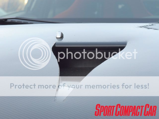

tfreer85 Posted May 31, 2009 Share Posted May 31, 2009 Problem: CFD Software for calculations. Must be free, opensource etc. Does anyone have any recommendations? I found this really cool website which has a lot of them (you have to scroll down a ways): http://www.imechanica.org/node/1394 Goal: To calculate the size requirements of a NACA duct split in half and still flow appx 150cfm I.E. a tradiotnal NACA duct flowing ~300cfm split in half and placed on opposite sides of the 240z hood for intake vents. I know realistically, just doing 2 traditional NACA ducts would work the best, but I'd like to go with something a little more aesthetically pleasing. Solutions: Any ideas? I have a calculator than can help me size the NACA duct, but in no particular relation to CFM. Traditional NACA Ducts: Commercial produced (not as functional) Quote Link to comment Share on other sites More sharing options...
