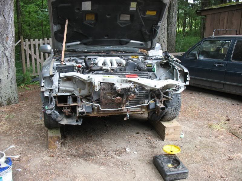

blaze73 Posted June 22, 2009 Share Posted June 22, 2009 Ok so I've been around hybridz for a quite a few years now but I'm sure not many of you know me because I mostly just sit back and soak up the wonderful info on here. I contemplated engine choices for quite some time and was fairly set on doing a basic turbo swap as it is pretty much the best bang for the buck but inside I really wanted some more displacement and instant response as the car will be a weekender/autox car. Last summer I found a great running '91 Q45 for $500 so I jumped on it. I've been in school for the last 10 months and xmas break looked like this... (Yes thats the Q!) So I haven't had a chance to start the project until now. Heres my progress so far.... Q rad in the Z...I'm thinking of doing a custom rad support with ducted front end, angled rad and vented hood ala 74_5.0L_Z.....thats hardly critical path at this point though... Any thoughts, suggestions, questions, or insults welcome! Quote Link to comment Share on other sites More sharing options...

blaze73 Posted June 22, 2009 Author Share Posted June 22, 2009 Thanks for the words of encouragement! I am well aware of the various other VH projects and will be taking bits and pieces from each of them. I plan on making a crossmember like you mentioned rearward of the stock one for the engine mounts, modifying the stock x-member for oil pan clearance and subaru power steering, likely a mazworx adapter for the z32 trans, possibly the Q45 diff with the Modern Motorsports mount kit/axles, etc. etc.....I have my work cut out for me. Quote Link to comment Share on other sites More sharing options...
