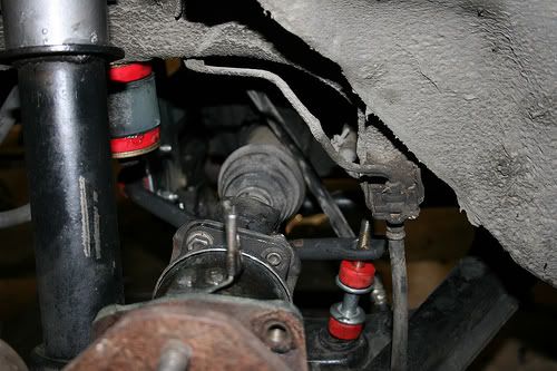

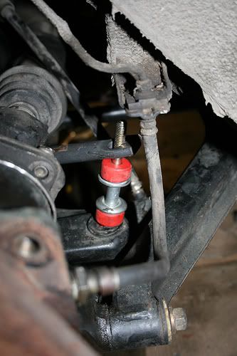

dsalni Posted July 14, 2009 Share Posted July 14, 2009 havent been able to find anything by searching. if there's a thread on this topic already, please let me know. i'm running into some problems while trying to insall a rear-facing 240z rear sway bar on my 280z. the reason for this, is because i'm converting the rear drums to disks, and want to make some room for the calipers and brake lines. i installed rear 240z control arms, and when installing the sway bar, i ran into this snag: the sway bar ends seem to reach a little too far forward in car, and create some binding between the swaybar and the a arms. is the 240z setup just not compatible with the 280z? or am i doing something wrong? any suggestions or advise would be greatly appreciated. thanks in advance Quote Link to comment Share on other sites More sharing options...
johnc Posted July 14, 2009 Share Posted July 14, 2009 Make two aluminum spacers about 1/2" to 1" thick and space the bar away (rearward) from the traverse link mounting plates. Also, get shorter bolts for the end links. Quote Link to comment Share on other sites More sharing options...
dsalni Posted July 14, 2009 Author Share Posted July 14, 2009 yeah that idea did pop into my head. i just wanted to make sure i didnt over-look some stupid mistake i might have made during the install. thanks for the help! Quote Link to comment Share on other sites More sharing options...
