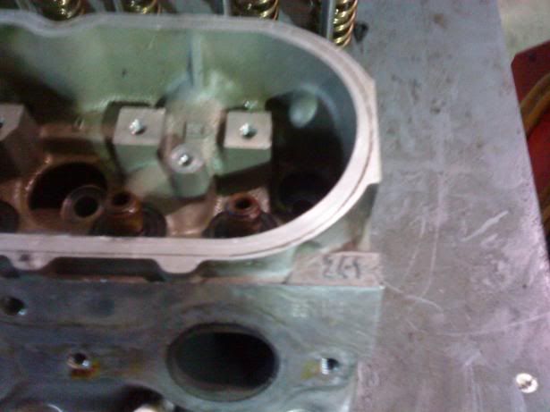

2) An extra set of LSx 241 heads came with the engine that I bought, because the guy I bought it from (who owns an LSx performance shop) recommended that I take the double springs off the 241 heads and install them on the engine I bought, which have single springs. I do not know the spring rates of either spring, but after removing them, it really feels like there was a noticeable difference in compressing the double spring versus the single (duh). It's a distant shot, but you can see the two springs side-by-side here.
Well anyways, the heads on the engine that I bought have been completely worked over, and that included new valve stem seals. Compared to the seals on the 241 heads, these things are beefy and look like they'd be high-performance. I'm assuming the 241 seals are OEM seals - here's more pics:
Beefy seals on the new heads:
And the OEM (I'm guessing) seals:
Now here's the problem, the inner-spring on the heavy-duty springs that I'm trying to install on the new heads rubs agains the valve stem seal, and I'm pretty sure it would result in destruction of the seal. So, if I want to use the heavier springs, is my only option here to swap out to thinner, OEM-style seals?
