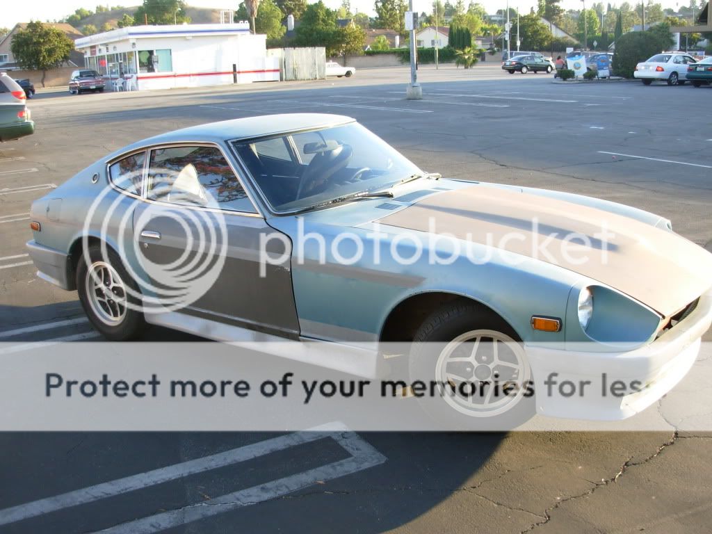

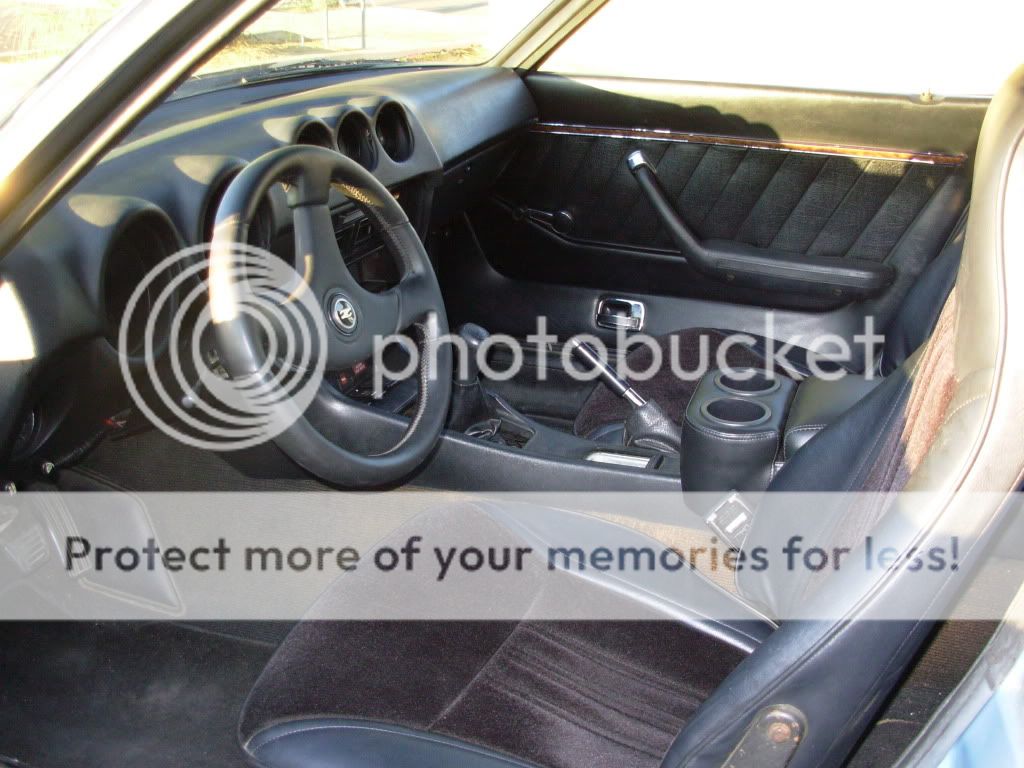

datsun723 Posted September 17, 2009 Share Posted September 17, 2009 Hey all. I just picked up this Z tonight. I got a smokin' deal on her and am quite pleased with my purchase. I can't drive it till next week when it's registered though Anyways, it's a '75 so I'm good for not having to deal with emissions and whatnot. It's stock for the most part but it does have a MSA body kit which I don't really want. If anyone local wants to make an offer and pick it up, shoot me a pm. Here's the goods: Interior: New upholstered seats, new premium carpet kit in the box, new steering wheel, new half dash cap, MSA armrest w/cupholder, new window felt and regulators and a couple of 5 1/2's in the back. Engine: Rebuilt ZX engine, newer hoses, plugs etc. 6-1 ceramic headers Suspension: Tokico springs, not sure on the struts, new tie rod bushings. I need to check the other bushings but it feels great! Nice and tight Exterior: It needs attention. There is almost no rust in the entire car. Floor pans, rockers, frame rails all straight. It's a great car. Needs a tuneup since it's sputters under heavy throttle but the old cat isn't helping matters either. I"ll be updating as I go. Quote Link to comment Share on other sites More sharing options...

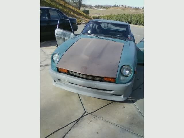

datsun723 Posted October 10, 2009 Author Share Posted October 10, 2009 Update: Still haven't gotten the car registered. I ended up getting the '78 clay bared and that cost some pretty pennies but I think I can this coming tuesday! And if all goes according to my evil scheme, I should have the body kit off next weekend To be continued... Quote Link to comment Share on other sites More sharing options...

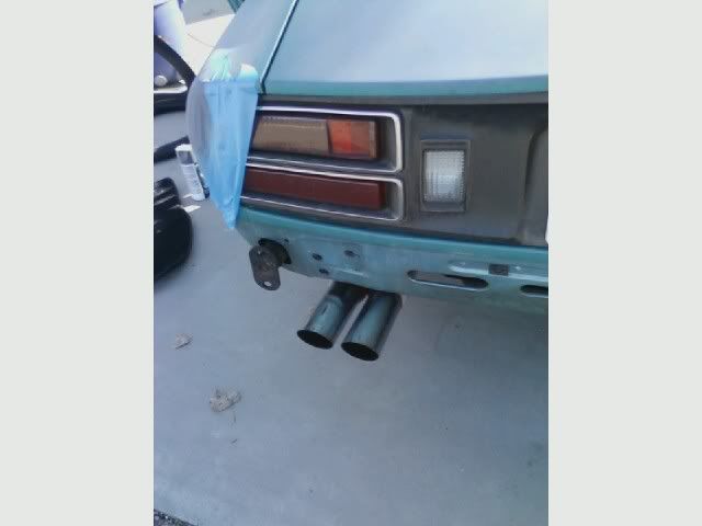

datsun723 Posted November 16, 2009 Author Share Posted November 16, 2009 Twice pipes! Quote Link to comment Share on other sites More sharing options...

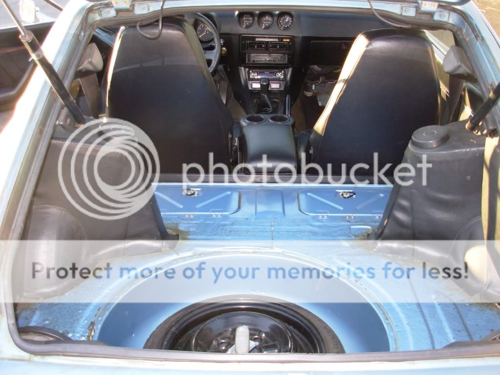

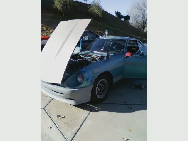

datsun723 Posted December 25, 2009 Author Share Posted December 25, 2009 Hey guys. So I've been working on the floors today and have gotten a lot done. I still need to grind both sides and paint but thought I'd put up the progress pics from today. I used 12 lbs of dry ice and I think I should have gotten 15 but it was enough for what I wanted to do. I am not doing the trans tunnel, hatch, or the rubber underneath the seats. I may change my mind and still have some time until I get the passenger floor welded. The PO jacked right through the floor *face palm* Anywho, it really wasn't hard. More time consuming than anything. What I wasn't expecting, and I guess I should have, was that while I was whacking the floors, the undercoating underneath the car came off in certain places too. This car is my dd so there is no way I'm going to strip it all and do a rotisserie job like some members are currently undertaking. No thanks! Haha. I just went out and got some Duplicolor rubber undercoating and am going to spray the parts that came off. Its super clean underneath so I'm not worried. I was like, "OH CRAP!!!" when I saw it though. Be forewarned! Quote Link to comment Share on other sites More sharing options...
datsun723 Posted December 26, 2009 Author Share Posted December 26, 2009 Did some more work today. Here are the results. 2 coats primer and 2 coats paint. I'm doing the rubber undercoating tomorrow on the underside of the floors. I also did some sanding and painting of where the paint chipped and began to rust. I'm going to be getting some local quotes on a cheap sand and paint from an autobody shop. I need to get this thing one color haha. Quote Link to comment Share on other sites More sharing options...

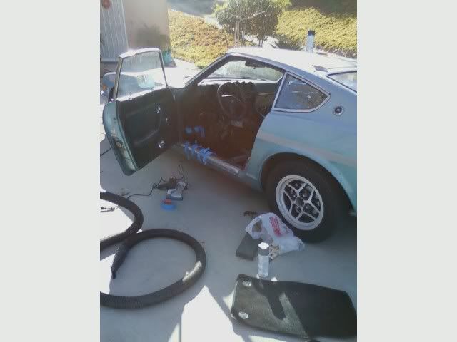

datsun723 Posted February 14, 2010 Author Share Posted February 14, 2010 Hey guys. I've gotten most of the interior sound deadening and carpet kit done. It was an intense job even with the precut kit from quietride.com The kit was very nice and went together smoothly. Took me and 2 friends a good 3-4 hours to get it all in. I don't have any pictures though It was taking so long I completely forgot. I'm finishing the stereo install today and will leave you with a sound clip, no video, of my Z. Idling and some quick revs. https://cubenet.ath.cx/temp/pub/Sounds/Cars/RafeZ.mp3 Me and my buddies Evo leaving our friend's house. https://cubenet.ath.cx/temp/pub/Sounds/Cars/Leaving.mp3 Quote Link to comment Share on other sites More sharing options...

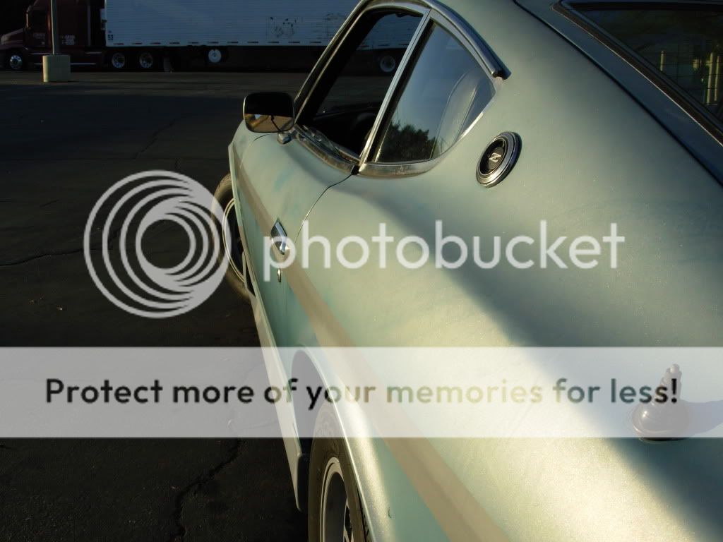

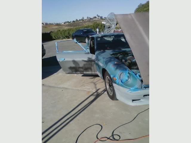

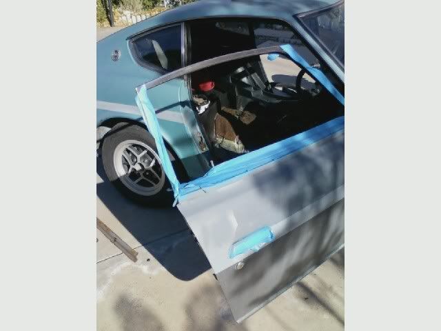

datsun723 Posted July 6, 2010 Author Share Posted July 6, 2010 Finally got around to getting the Z one color. Rustoleum is my friend Quote Link to comment Share on other sites More sharing options...
Stivva Posted July 7, 2010 Share Posted July 7, 2010 Definitely need day time photos Quote Link to comment Share on other sites More sharing options...
datsun723 Posted July 7, 2010 Author Share Posted July 7, 2010 Definitely need day time photos Working on it haha I didn't realize people could post in build threads now, awesome! Quote Link to comment Share on other sites More sharing options...
datsun723 Posted July 8, 2010 Author Share Posted July 8, 2010 Here are some more from tonight. I'm limited to my cell so they aren't super great Quote Link to comment Share on other sites More sharing options...
