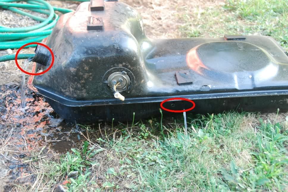

Here's a recent example...
Notice the circled areas. No water coming from the fuel supply nipple. In this case, the owner had the tank cleaned and coated. The coating failed and clogged up the pick up tube.
