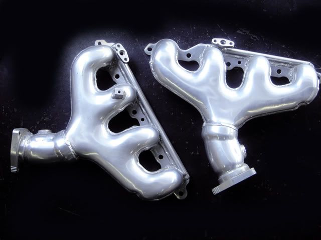

Caddy CTS-V exh mani's;
Caddy CTS-V LS6 exhaust manifolds arrived today.
Interesting manifolds these are. The outlets are 2 different sizes. Driver side is 2 3/8” opening, passenger is 2 5/8”?!?!shrug.gif On the driver side, there is quite a bit of material in the casting around the header pipe flange to open up the one side that is fed by the front 3 cylinders therefore balancing the outlet dimension a bit.
It is quite clear GM spent more time and attention on the Vette exhaust manifolds. It'll be interesting to see the LS2 Vette manifolds when they arrive later this week. :2thumbs:
Now on to the really cool part. These manifolds fit the Z-32 LSx with the engine sitting in this position PERFECTLY! (If you are moving your back, forward, up or down from the this location, no guarantee these will fit this nice).
Here be the pics, Cadillac CTS-V LS6 exhaust manifolds;
Parallax in the pic, actual measurement is 2 5/8" ID, not 2 9/16" as depicted
Here is the fitment in the mock up Z-32;
Driver side;
Passenger side;

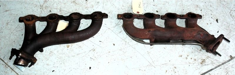

’98-’02 F-body exh mani's;
I need to correct you a tad bit Paul. There are actually two different F-Body LS1 manifolds. The earlier ones were made for '98-'99 and the later ones were '00-'02 (yours are the later version). The earlier ones were made from double walled steel with cast iron flanges and the later ones were made completely of cast iron.
Also, the '98-'99's fit a lot tighter to the block. I have a set of the earlier ones, let me see if I can take a pic and post it here.
I also have a set of 6.0 truck manifolds, I'll take a pic of those too while I am at it.
Link to comment
  • Administrators
Thank you for catching that mistake, :2thumbs: my apologies, correction made to the post.
Pics of your Stamped F-bod manifolds would be great.
Same also applies to the C5 Vette manifolds. Early version. ('97-'99) were the double wall stamped sheet-metal, not sure if they were dimensionally any different.
Here are the early Vette stamped manifolds;
Edited by BRAAP
