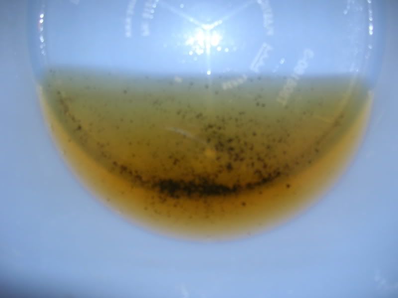

Xnke Posted January 31, 2010 Share Posted January 31, 2010 Ok, so those of you (like myself) who pull fuel injectors from the junkyard to do your barbed-to-O-ring conversions, get them cleaned! This is the junk that came out of 6 Mitsu 4G64 injectors, type INP-065 275cc/min. Really easy to pull from Mitsubishi Galants, two bolts and they're 11mm o-ring types. 5-6$ each at Pull-a-Part type places, usually. That's lacquer thinner, BTW, and was crystal clear when i started cleaning. The injectors were scrubbed down on the exterior PRIOR to being flushed and backflushed into this bucket. That's two passes forward and backward, from 6 injectors! That's a LOT OF CRUD! After flushing, I replaced all the o-rings and the filter screens, and now they're ready to use. Sure, not as good as if i sent them out to be cleaned, but certainly good enough to run, they all seem to flow within a few percent, as timed by my stopwatch and a graduated cylinder. Quote Link to comment Share on other sites More sharing options...

Xnke Posted February 1, 2010 Author Share Posted February 1, 2010 I use a pulser I built, and hit them at 10Hz pulses to flush them. After doing the first 16 of them by hand by slamming them with 12V, I got tired of hitting the button, so built the pulser. These are high-impedance injectors I'm working with, so the 12V is fine on them. From the photo above, I'm pretty sure no one cares what kind of gas they run in there '94 galant...all four sets of injectors I pulled from the galants were from '94 models, and all four sets were just as gross. Nasty stuff. Quote Link to comment Share on other sites More sharing options...
