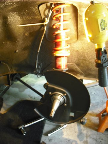

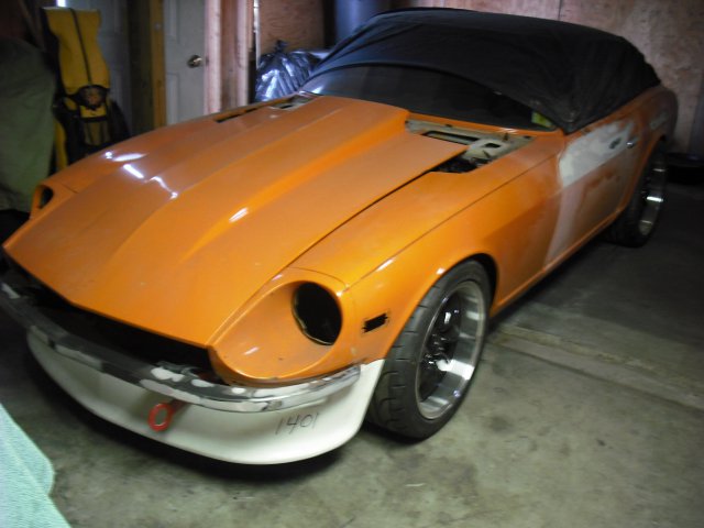

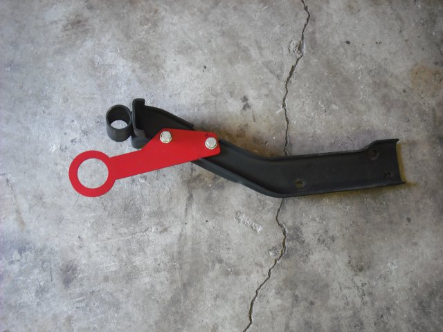

Tank Posted April 7, 2010 Author Share Posted April 7, 2010 I have finished the suspension project. I sectioned the front strut housings for the BZ3099 and have 225lb springs installed. I also finished the brakes. I ended up putting the proportioning valve on the firewall in the location of the stock unit for the time being. Everything works fantastic except for my e-brake, it needs some work. In image 005 you can see clearly where I notched backing plate to clear the steering knuckle. Image 014 shows the modification to the bumper mount for the tow hook. On to body work! Quote Link to comment Share on other sites More sharing options...
DCZ Posted April 9, 2010 Share Posted April 9, 2010 Looks great! LOVE the tow hook! I could have used that many (too many) times! Quote Link to comment Share on other sites More sharing options...
Tank Posted April 9, 2010 Author Share Posted April 9, 2010 Thanks, I figured I would need those a time or two! Quote Link to comment Share on other sites More sharing options...
Two80z4me Posted April 9, 2010 Share Posted April 9, 2010 nice, I need to get one for the back and front of my car. damn tracks around here are sticklers. Quote Link to comment Share on other sites More sharing options...
Tank Posted April 9, 2010 Author Share Posted April 9, 2010 nice, I need to get one for the back and front of my car. damn tracks around here are sticklers. I bought mine at zccjdm.com and modified the front bumper mount for it ['73 bumper mounts]. The rear required no modification. Quote Link to comment Share on other sites More sharing options...
