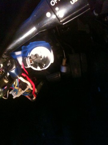

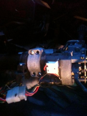

slipknotanfitch9 Posted February 11, 2010 Share Posted February 11, 2010 This is my 280z I bought last weekend ,The first picture is where the ignition bolts to the steering shaft, I got two of the screws off but the other two do not appear to come out, is there anyway to fix this? the second picture is where the key goes in, I'm guessing its missing the whole assembly. I need to know what I have to do to make it work. I can stick a flathead in there and turn it like there was a key in it. I know nothing about the key thing so don't hesitate to explain like I know nothing. thanks guys Quote Link to comment Share on other sites More sharing options...
leftover z Posted February 11, 2010 Share Posted February 11, 2010 Those were the "anti-theft" screws that Datsun used. You can use a Dremel tool to cut a slot, then use a standard screw driver to get them out. Or you could drill it out. Quote Link to comment Share on other sites More sharing options...
slipknotanfitch9 Posted February 11, 2010 Author Share Posted February 11, 2010 Ok so there not ment to come out. Sure that makes sense haha. Well there's one question down, I called abc last night and they want 150$ for the ignition cylinder thing. Sooo I think I'll be using a screw driver for the time being. Quote Link to comment Share on other sites More sharing options...
