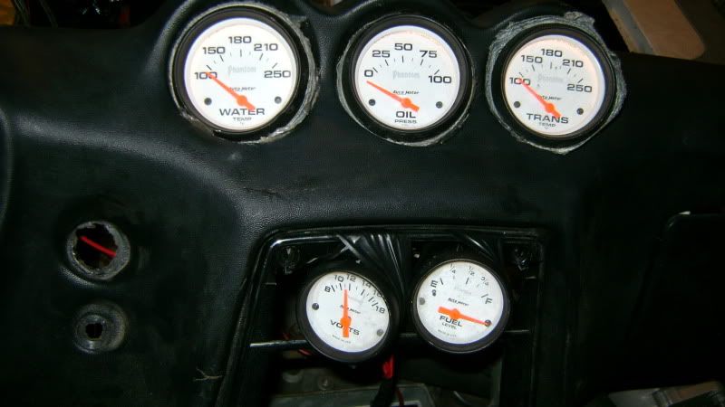

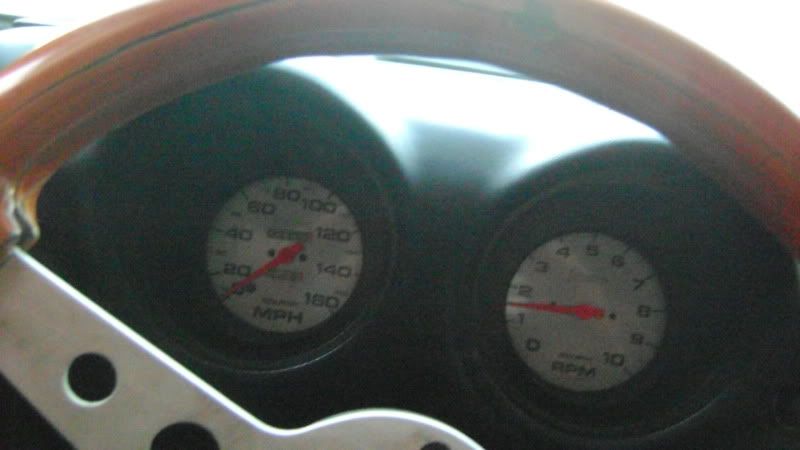

sweetride2go Posted February 11, 2010 Share Posted February 11, 2010 I think as most of us that have done gauge swaps have realized, is that one gauge in the center three will have to go. So for me, I decided to have the most important gauges there, which was; temp, oil pres, volt. I stuck the fuel gauge on the center console. I also have a fuel pressure gauge, but it resides under the hood. As far as the big two gauges, I took them apart, drilled into the face and installed LED's in them as 'turn signals' and 'high beam indicator'... I went with AutoMeter gauges, but if I had to do it all over again, I would spend more time and strongly consider the Speedhut gauges. A little searching will reveal several installs on both makes of gauges. That's my .02 , hope that helps... Cheers Ryan~ Quote Link to comment Share on other sites More sharing options...
hoov100 Posted February 11, 2010 Share Posted February 11, 2010 I did this (see below) as for the indicators, if you can hear the relay clicking for the turnsignals, most likely they are still on, for the headlights, it doesn't really matter as they suck both ways. Quote Link to comment Share on other sites More sharing options...
sweetride2go Posted February 11, 2010 Share Posted February 11, 2010 Haha, I agree with Hoov. The flasher makes plenty of noise, and the high beams are pretty noticeable, either that or someone will flash you letting you know that your high beams are on. So, to throw in another .02, and if I were to do it again, I wouldn't bother with the indicators. That, and they were kind of a PITA to install... Cheers Ryan~ Quote Link to comment Share on other sites More sharing options...
