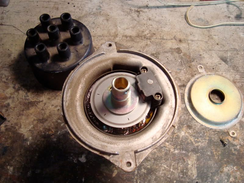

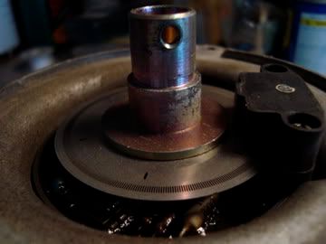

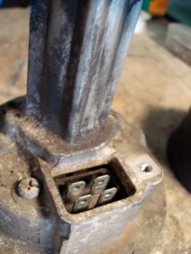

palauoriginal Posted February 15, 2010 Share Posted February 15, 2010 So i bought a box of Z efi parts because im piecing stuff together for my ms swap after searching through it today i found this dizzy i think it's a turbo distributor but im unsure If it is what mods would i need to use it with megasquirt? (its going in an l28) anyone have digram of the plug under the distributor? any help is appretiated Quote Link to comment Share on other sites More sharing options...
S130Z Posted February 15, 2010 Share Posted February 15, 2010 http://www.diyautotune.com/tech_articles/how_to_megasquirt_your_280zx_turbo.htm Also check the stickies under the MegaSquirt section. If you have any questions about the swap, feel free to PM me. And yes, that is an 82-83 Turbo optical dizzy. Quote Link to comment Share on other sites More sharing options...
letitsnow Posted February 15, 2010 Share Posted February 15, 2010 The diagram for the plug is in one of the stickies up top. As for MS mods, just use the hall/optical input circuit. Do you have the oil pump shaft? You'll need the 82-83 turbo shaft to use that dizzy. Quote Link to comment Share on other sites More sharing options...
