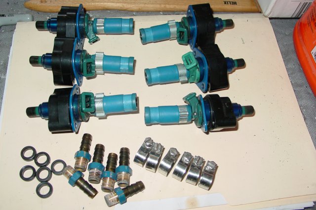

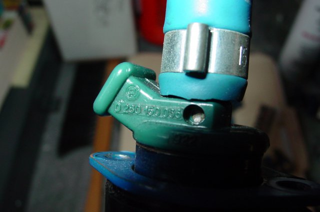

zxtman Posted March 17, 2010 Share Posted March 17, 2010 ...is this the injector you are using??? Quote Link to comment Share on other sites More sharing options...
jyz77 Posted March 19, 2010 Share Posted March 19, 2010 yes. those are the injectors that i am running. Quote Link to comment Share on other sites More sharing options...
zxtman Posted March 22, 2010 Share Posted March 22, 2010 yes. those are the injectors that i am running. I have the connectors. Also, the injectors are good and are for sale (cheap). Shoot me a pm. Quote Link to comment Share on other sites More sharing options...
