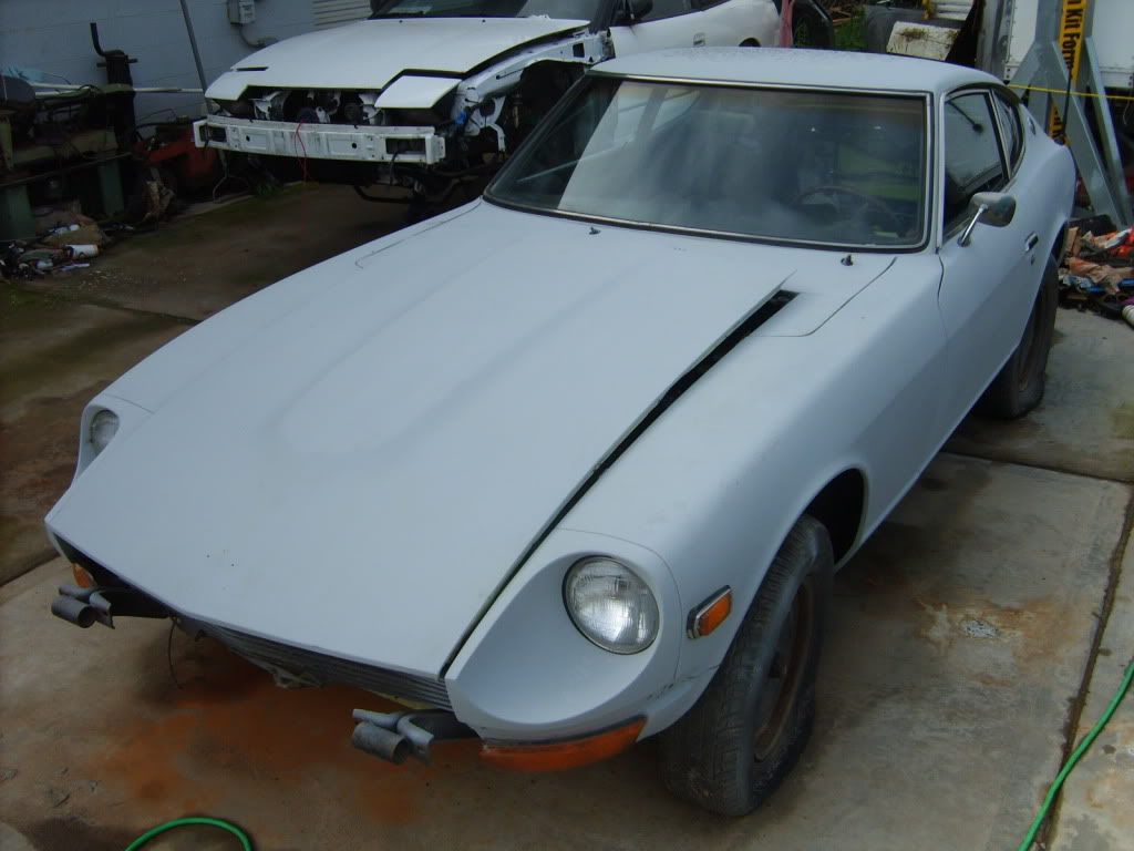

73 240z, No rust that I can find so far so pretty happy about that. My last z was a rust buctet

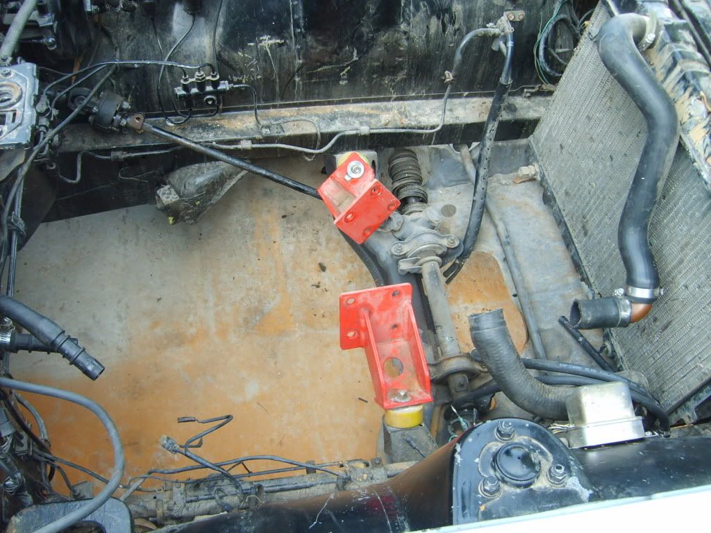

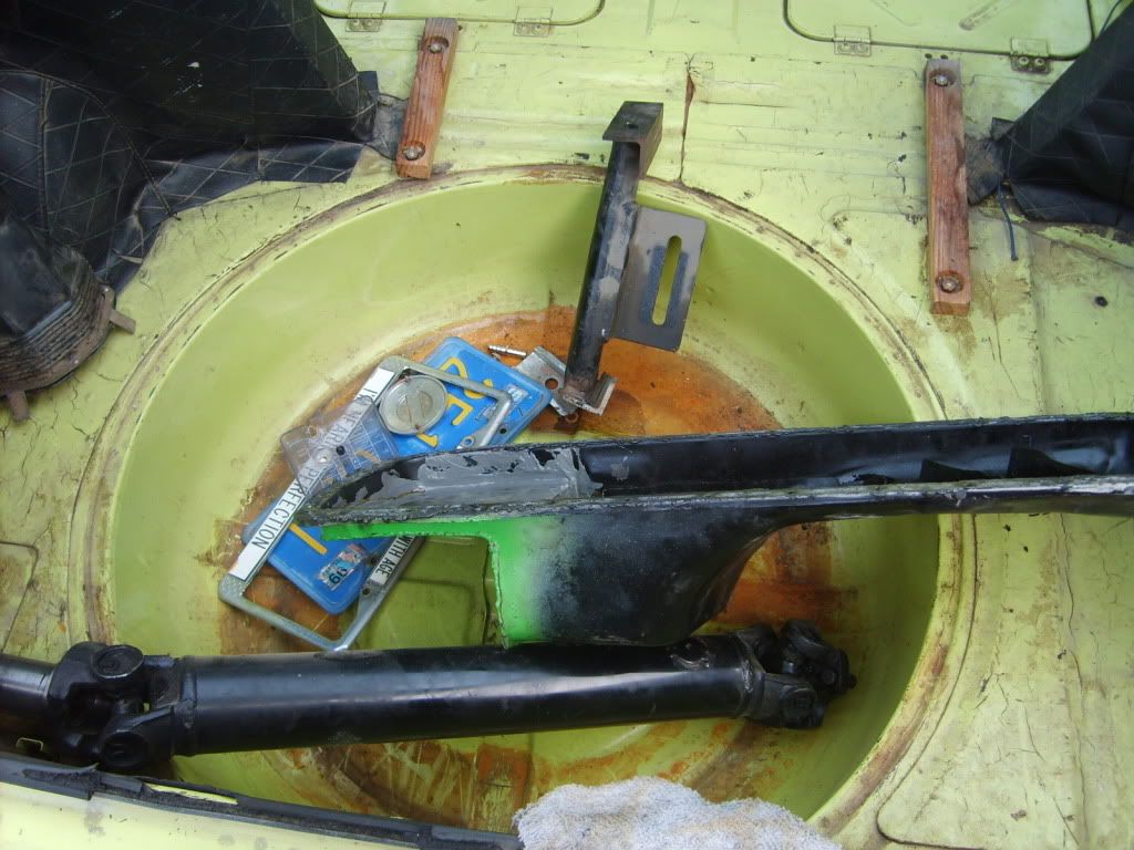

The motor mounts, drive shaft and oil pan where part of the trade
Mchinney motor mounts and drive shaft and the oil pan I needa mod some more to put its capacity back to atleast stock

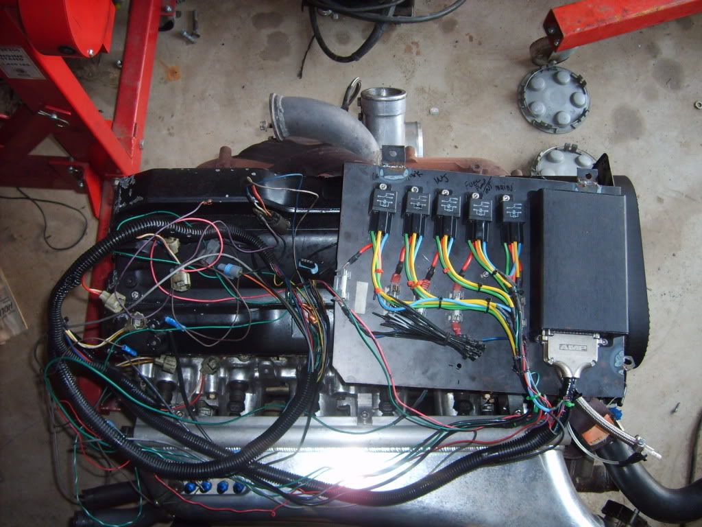

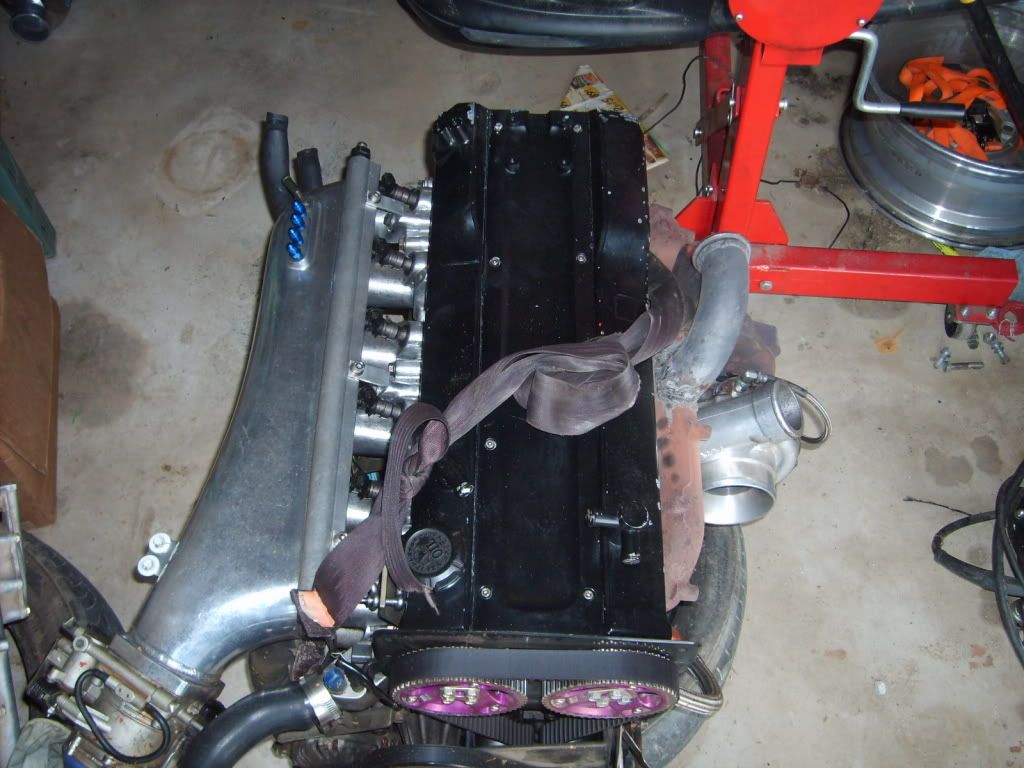

This is the NEO6 I was running in my S14. Current mods:
ARP head studs
Tomei 1.2mm head gasket
JUN style intake manifold
Q45 throttle body
JYC top mount injector rail
440cc top mount injectors (Tooo small....)
Rb20det intake cam
HKS cam gears
HKS timing belt (I had a oil leak thats why its black...sucks....)

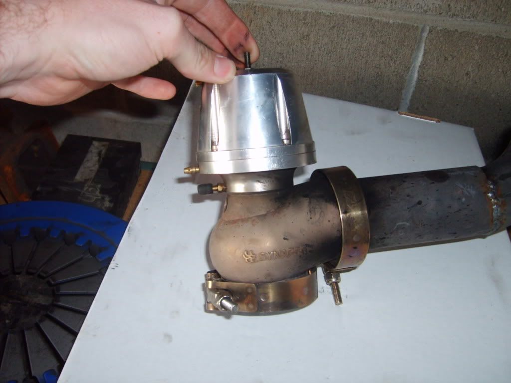

Stock turbo mani moded for external wastegate
Synapse 50mm wastegate
Ebay t3/t4 70 ar 63 ar stg 3 turbo (Have a turbonetics BB t4 turbo to replace it.. I'll show ya later)
Megasquirt EMS
Well its a start.

From what i was told they are mchinney motor mounts, Yea they bolt to the stock motor mount holes
