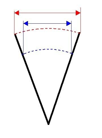

Skittle Posted March 9, 2010 Share Posted March 9, 2010 Nice write up but this does not "shorten" the throw does it? As in what are the benefits of just shortening the arm? Quote Link to comment Share on other sites More sharing options...
Administrators BRAAP Posted March 9, 2010 Administrators Share Posted March 9, 2010 It sorta shortens the throw due to its geometry. Shorter arm swinging same arc, now travels less distance. It makes a very noticeable difference. I personally prefer the feel of the shifter shortened by 1"-1 1/4", seems to be the sweet spot. RED being stock length, BLUE being shorter length. Note how it shortens the throw. Quote Link to comment Share on other sites More sharing options...
