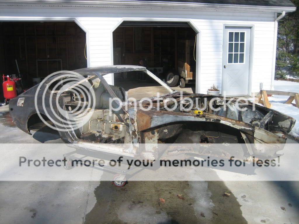

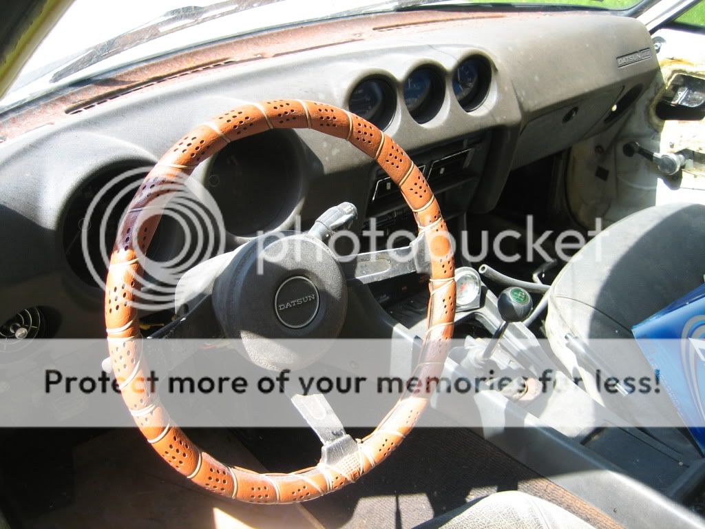

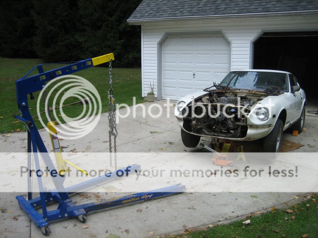

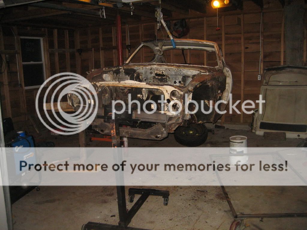

vekford Posted March 15, 2010 Share Posted March 15, 2010 I purchased a 1975 280z from a friend when he picked up a Porsche 951 and needed to make some space in his garage. I have always liked the lines of the Datsun Z cars and I could not beat the price. I am officially the second owner of the car although it has changed hands several times before reaching me. The car sat in a barn in Michigan for ~10 years before my friend purchased it. There is a large amount of rust to be dealt with, but nothing that cannot be done. Starting reading Hybridz about 6 months ago when I got the car and have learned tons of great stuff about these cars. Not exactly sure what direction the car will be taking (mostly budget dependent) but it should be fun. Anyways, on to some pictures: The car the day it arrived at my house. The car had an original un-cracked dash, I even removed it without it cracking. Then I stored it while I was back at school between breaks, came back, and sure enough it cracked. Oh well. Motor about to be pulled over fall break. Original window sticker from the vehicle. Fast forward a few months of general work, and this is how the chassis sits now. Now that I have graduated and am back home, I have been able to work on the car quite a bit more. Due to living in the snow belt and the amazing weather we have, I have mostly been working on individual parts and assemblies. More to come soon! Quote Link to comment Share on other sites More sharing options...

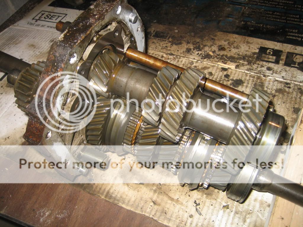

vekford Posted March 15, 2010 Author Share Posted March 15, 2010 This is the first time I have attempted to perform work at this level for a street car, so it is quite a good learning experience for me. As such I decided to disassemble the transmission and clean/inspect everything. Replaced gaskets, oil seals, slave cylinder and clutch hose. Reassembling took longer than I expected due to unclear instructions in the fsm about where the shift rod needed to be positioned in order to catch the shift forks correctly. Got it all together and tested all the gears to make sure forward=forward and reverse=reverse. Transmission as removed. Guts. All cleaned, painted, and assembled. Quote Link to comment Share on other sites More sharing options...

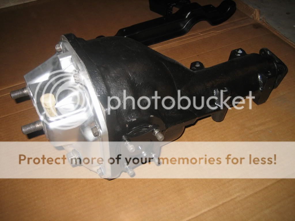

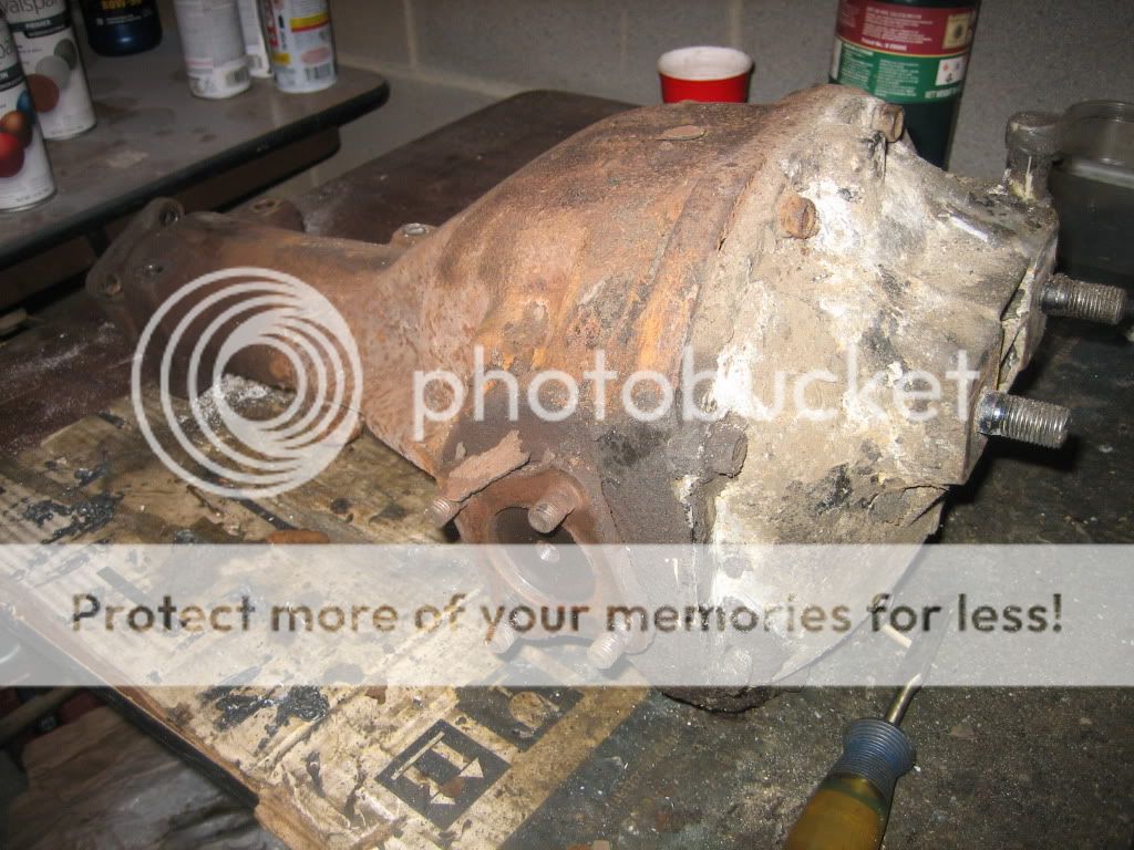

vekford Posted March 15, 2010 Author Share Posted March 15, 2010 (edited) After finishing the transmission the differential was next on the list. Same thing as before, tore it all apart/cleaned/inspected. Replaced the oil seals and rear gasket. Got it all put back together about a week ago. Diff fresh out of the car. Diff itself looked good. I would like to upgrade to a LSD, but my budget as pushed that off for a while. All cleaned up and finished. Edited March 15, 2010 by vekford Quote Link to comment Share on other sites More sharing options...

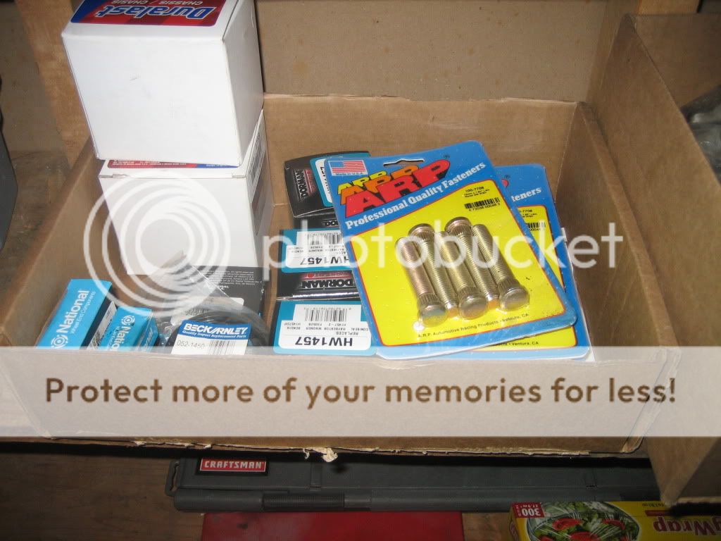

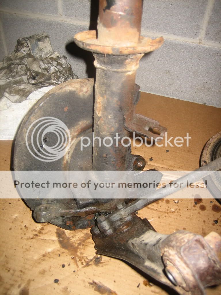

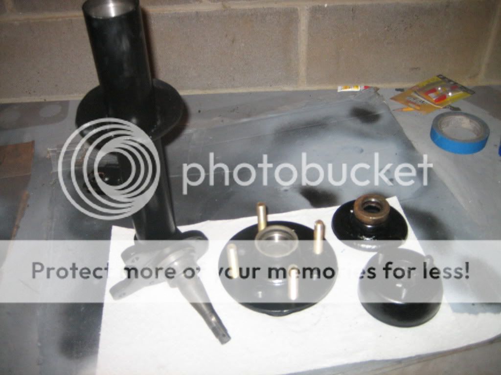

vekford Posted April 3, 2010 Author Share Posted April 3, 2010 (edited) Progress has been slow, but things are getting done. Too much time is spent waiting for parts only to find out that they are incorrect. Anyways, I finally finished the first of the suspension assemblies, only waiting on back ordered brake pads. Tore the assemblies apart, de-rusted and cleaned everything. Painted all the components are replaced both wheel bearings, the inner wheel seal, and ball joints. Upgraded to ARP wheel studs. Decided to go with Tokico Blue's, Eibach springs, rebuilt calipers, MSA bump steer spacers, R1 Concept rotors, stainless lines, and Hawk Pads. The driver side assembly is currently being cleaned and hopefully will be assembled shortly. Edited April 3, 2010 by vekford Quote Link to comment Share on other sites More sharing options...

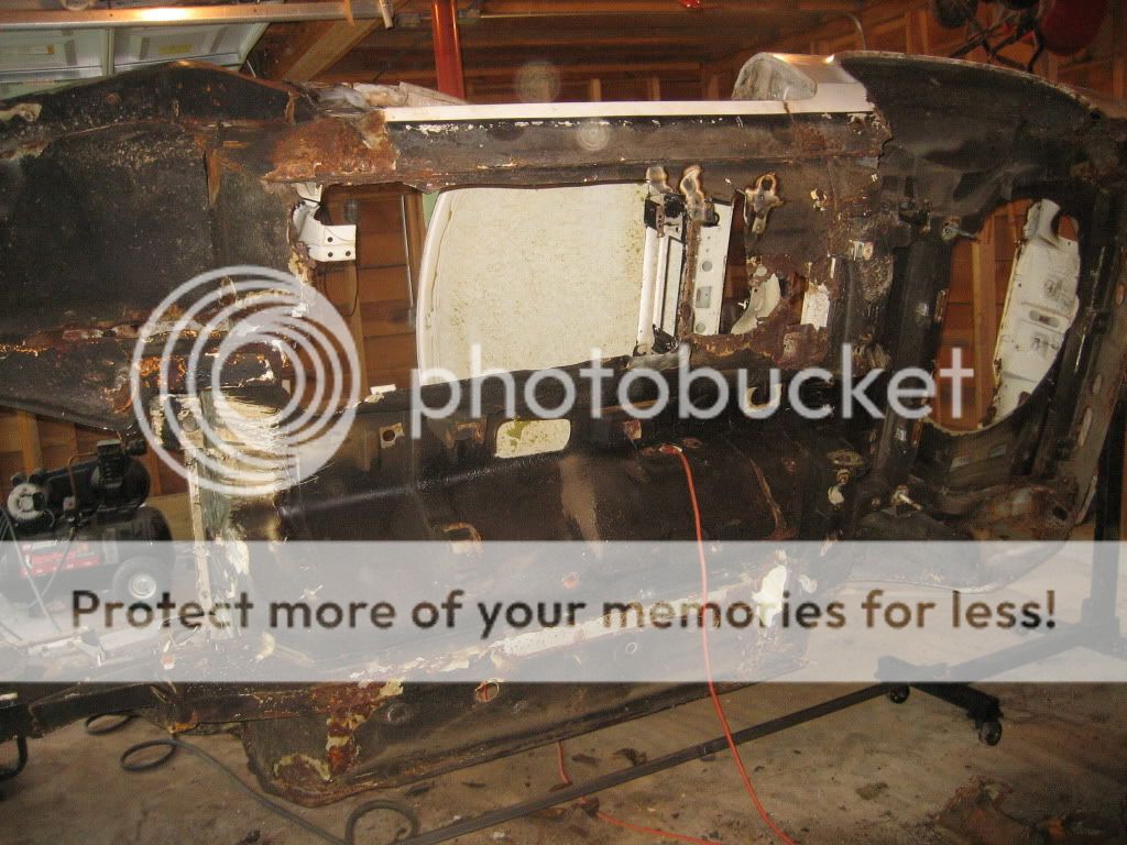

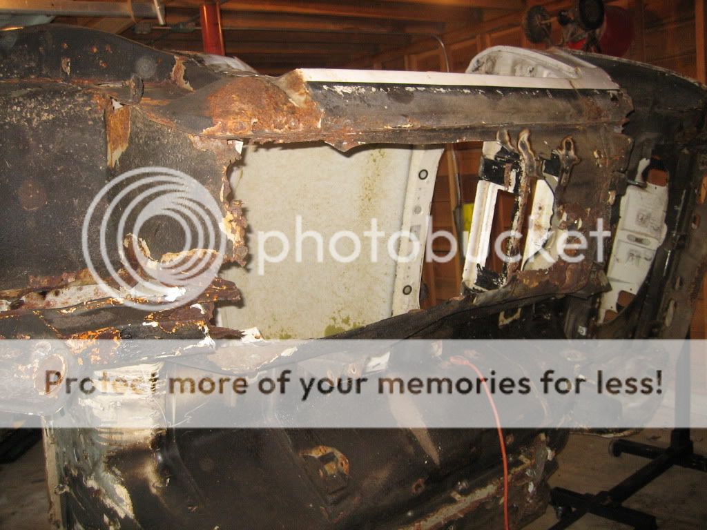

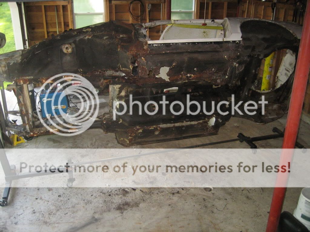

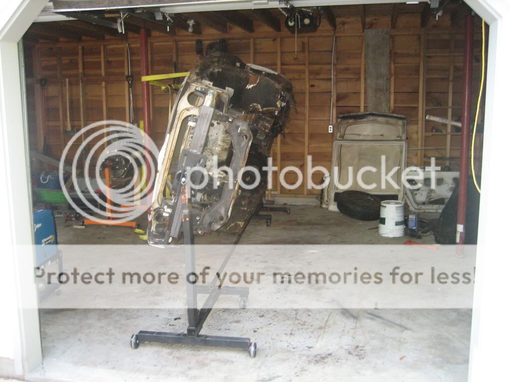

vekford Posted May 7, 2010 Author Share Posted May 7, 2010 Progress went from slow to a crawl recently as I started a new job...but at long last, some progress has been made. Both front suspension assemblies are finished, and I am starting to clean-up the rear assemblies. For now, the car is going to be taking a budget build/get it back on the road type approach. I am seriously taking it down the heavy mod path this winter though, after I enjoy it some. Decided to join the rotisserie club recently Started removing the floors. I think I am going to attempt to fab up some simple sheet floors with some bead rolled reinforcement, as it should cost ~$200 including bead roller. Quote Link to comment Share on other sites More sharing options...
