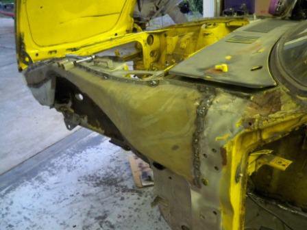

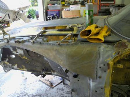

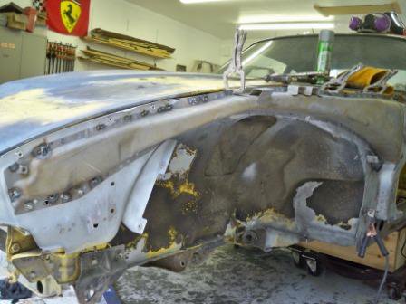

Inner fender replaced
This '77 had been tapped on the drivers side and the inner fender support suffered some damage, nothing to impact the integrity of the car, and its hidden under the fender but since I had a good panel to install I removed the old one and installed this one this weekend. First I media blasted it and the area underneath, shot the car area and the inside of the reinforcement with epoxy and treated the weld areas with weld through primer.
