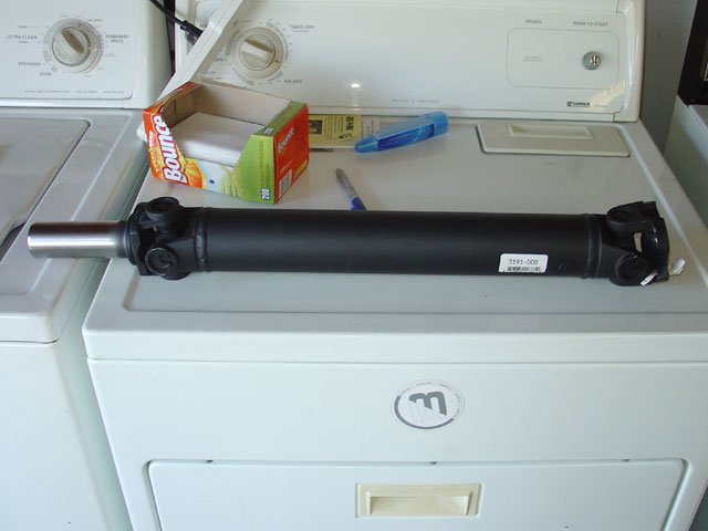

240Z_Master Posted May 17, 2010 Share Posted May 17, 2010 I got my driveshaft made at http://www.powertrainindustries.com/ The only measurement I needed to give them was the distance from the face of the differential to the end of the output shaft on the tranny... then I told them which diff I had on my car, and which type of tranny yoke I needed and they made it... Fit like a glove. Quote Link to comment Share on other sites More sharing options...

240Z_Master Posted May 18, 2010 Share Posted May 18, 2010 Thanks for that link they look like the have pretty good prices and know what they are doing. I honestly think I paid 200-250 bucks for my driveshaft a few years back.. and it was a brand new piece.. no used parts or anything like that Quote Link to comment Share on other sites More sharing options...
