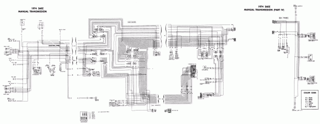

I went through on paint and took out all the wires that i shouldn't need to have in my harness. I only want this for power to the car nothing else. That means only the headlights, turn signals/hazards, brake lights, revers lights, dome light, horn, wipers, license plate lamp, and rear defogger. I am going to make my harness from scratch for all my gauges, so i took all those out. I put new Autometer gauges in that's why. If someone could take a look at this and let me know if this will work. This is for a 260z that has an Rb25det engine swapped into it. Thanks in advance. MOTOMAN
