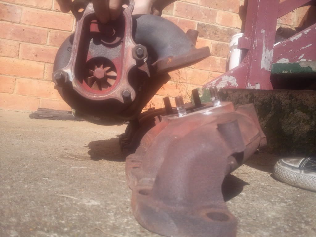

this is my VQ30 turbo positioned as close as it can be if the mating surfaces are to be parallel

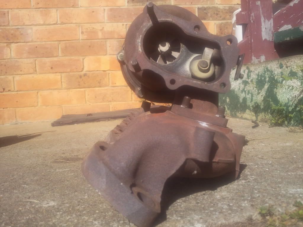

and the standard turbo in position

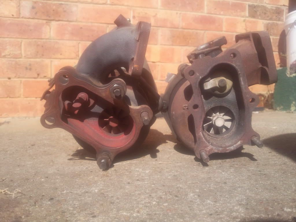

and this is the two turbos side by side (VQ30 turbo on the left and RB20 turbo on the right)
