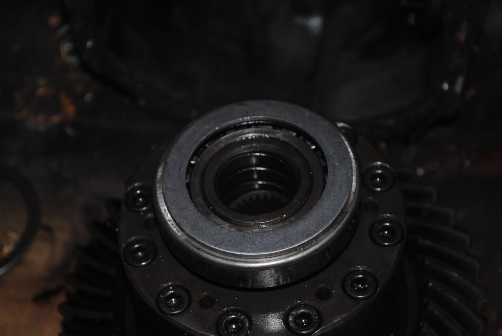

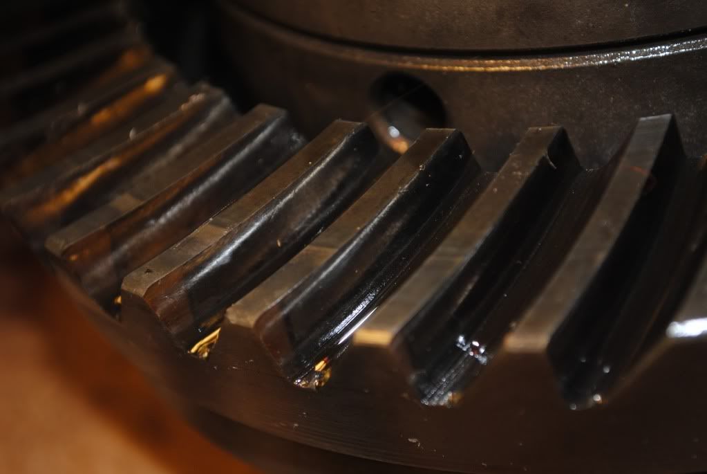

Geking Posted June 18, 2010 Author Share Posted June 18, 2010 (edited) I got home and took some photos. I guess I did not notice it before, but there is some wear on the gears. Notably on the flat side of the ring gear teeth and the back of the pinion gear teeth. Is it too bad? Should I call this one parts? EDIT: Looking at the pinion gear, it is not as bad as it looks. Because the dif got hot, the carrier gear has black crud on it. The extremely shiney parts are just lacking the crud, there is no noticeable run out or wear, at least in my opinion. Edited June 18, 2010 by Geking Quote Link to comment Share on other sites More sharing options...
JMortensen Posted June 18, 2010 Share Posted June 18, 2010 Tough to tell by the pictures, but when gears get hot like you described, I'd tend to want to just get another one. You can always just assemble it and see what it does. Cross your fingers. Quote Link to comment Share on other sites More sharing options...

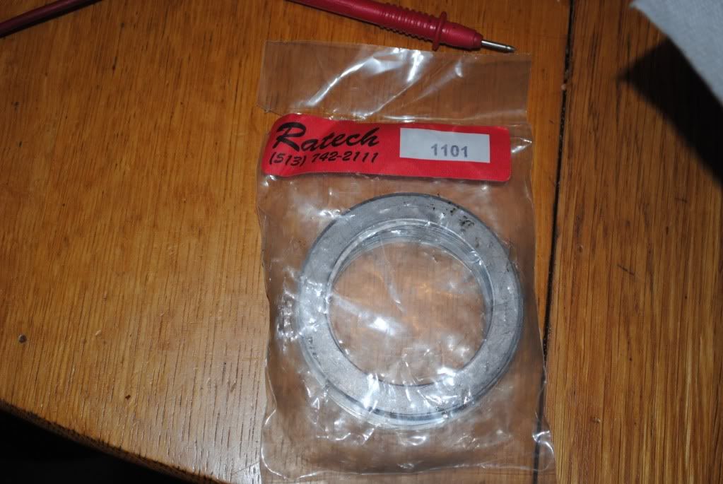

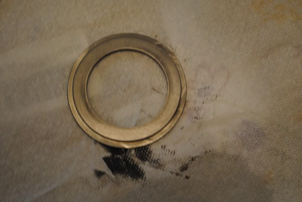

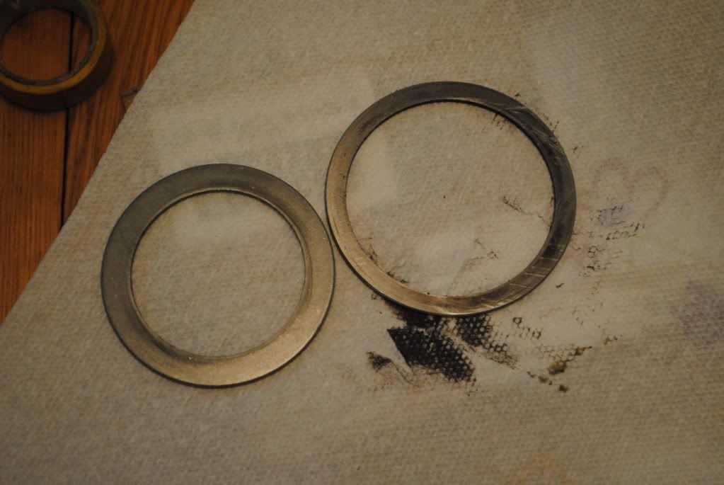

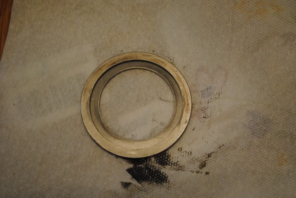

Geking Posted June 23, 2010 Author Share Posted June 23, 2010 (edited) per the last few posts of http://forums.hybrid...n-differential/ I ordered the GM 12 bolt shims As I have not found anyone else posting definitively on whether or not these will work, I thought I should. packaging The Nissan shim is on the right. partnumber from summit. It includes 4 X 2.5mm shims, 2 x .5mm, 2 x .4mm, 4 x .3mm and 2 x .23mm shims. Edited June 23, 2010 by Geking Quote Link to comment Share on other sites More sharing options...
