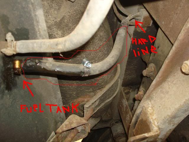

xShodaimex Posted June 24, 2010 Share Posted June 24, 2010 (edited) The vehicle is a 260z I checked under the car and I saw that one of the hoses is really old and cracked. I am not too sure what size it is. I have checked on my torn up factory manual but found nothing. [really torn, pages everywhere]. The hose wont budge so I was going to cut it real fast and just connect the new hose to it. Need help to Identify the hose size. I've tried searching but many have used different size hoses such as 1/2 , 7/16 , 3/8. I want to know which one to use. I circled the hose in red. Thanks for looking. Edited June 24, 2010 by xShodaimex Quote Link to comment Share on other sites More sharing options...
Tony D Posted June 27, 2010 Share Posted June 27, 2010 Fuel Feed: 5/16" (8mm) Fuel Return: 1/4" (6mm) I think your fitting is return. Quote Link to comment Share on other sites More sharing options...
xShodaimex Posted June 27, 2010 Author Share Posted June 27, 2010 Fuel Feed: 5/16" (8mm) Fuel Return: 1/4" (6mm) I think your fitting is return. I was also thinking return. Thanks Tonyd! Quote Link to comment Share on other sites More sharing options...
