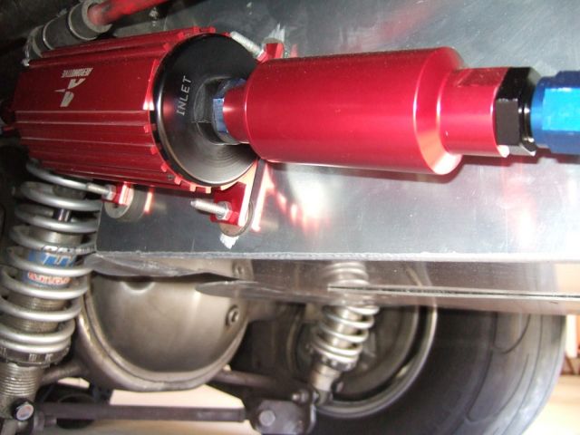

Turbo Meister Posted June 26, 2010 Share Posted June 26, 2010 (edited) Planning to put one of these on my 240z turbo, does somebody knows where is the best place on the car to put this in, do we need to built a mount ? My Z uses two A1000's mounted on either side of the fuelcell cover. I turn one on for driving around town and both of them to race. They are loud but my exhaust is slightly louder. They are 6 years old and still functioning. Edited June 26, 2010 by Turbo Meister Quote Link to comment Share on other sites More sharing options...
