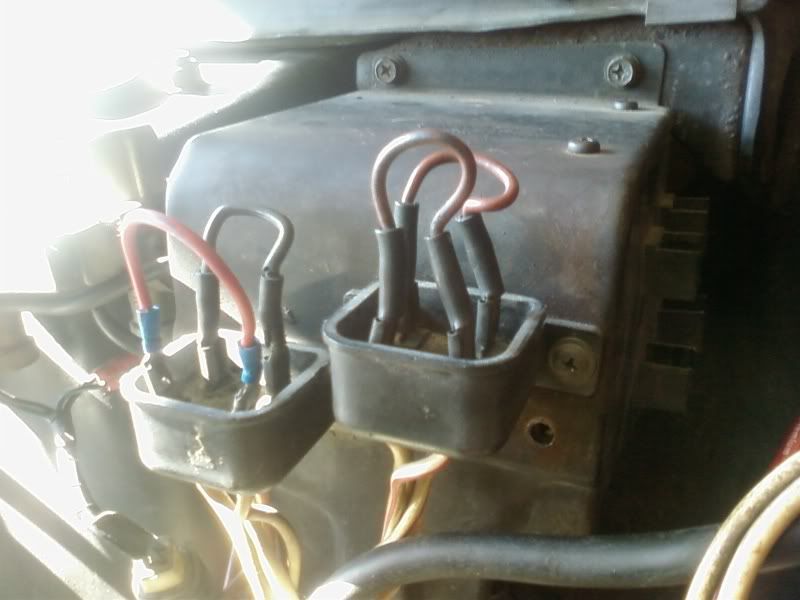

Pic0004.jpgwell i havent found a red wire, but i checked all the grounds on the wireing harness. They get good strong voltage. i followed the harness, every thing looks pluged in. Im adding a picture of my fuse links, so u all can let me know if they in the right order.

I want to thank you all that tryed to help, after all this time, we found out the problem, ecu had mysterously died, and the head i bought that was already asymbled had 3 bent valves and more issuse. I got my stock head rebuilt with a 3 angle valve job. after 2 days of cranking the car finally catch. It lives lol. It still need ajustment but it feel way stronger then before we tore it down. It starts up flawless.
