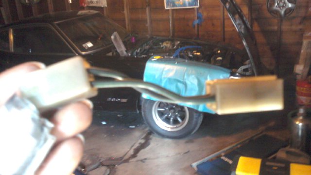

  16. thats the wire between battery and your fuel injection relay. do any one know what this plug is called lol. i hope to try to find a new one lol. it look like 2 green fuseable links in connectors
  17. i was thinking of doing a racing pump also
  18. Hey check to see if the green wires coming from the battery is good, i found out it was my problem.
  19. So I found the problem , it was the 2 green fuseable links that on a plug, i reconected it and the car started but i would like to find a replacement for it. im a put the picture up to see do any one know what it is called

  21. Im planing to do the same, I didnt blow my fuse links, mine was so old they kinda feel apart. lol

  24. Ok im intrested to know what have any of you all done about the fuseable links, replaceing them, upgrading them? If you have pictures of what you have done to fix them or upgrade them, ill love to see. If ytou did just replace them in the same style, did you order new ones or did any one make there own?
