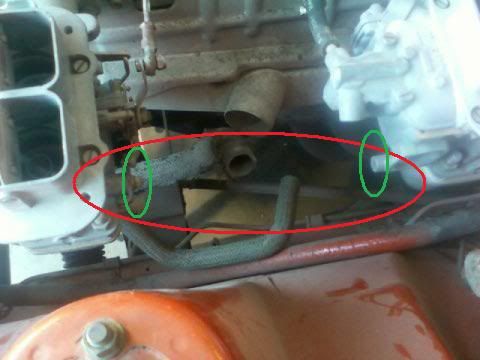

RED: these appear to be vaccuum hoses that the previous owner put golf tees in. does anybody know where they connect to?
Green: there are holes which are threaded and look like something can be screwed into them. does anyone know what they are for ?

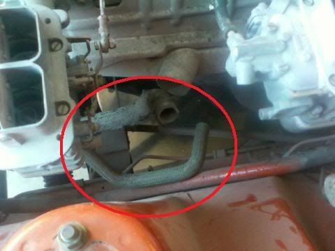

RED: anybody know where i am to connect these to? and with what size hoses ?

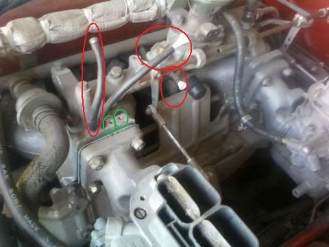

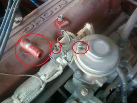

Red: im assuming these are something to do with emissions. now that i have the dgvs can i just leave them there or take them out ?
RED: DGV guys is the vacuum hose which connects the two carbs by the green circles necessary?

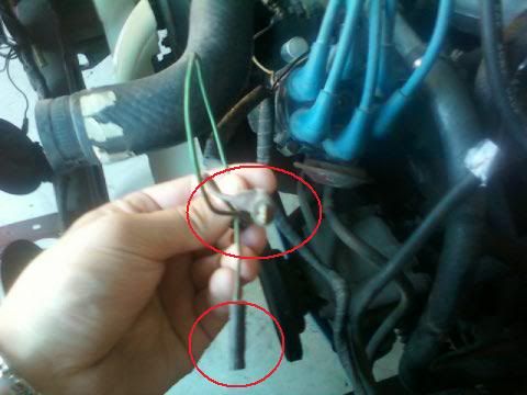

RED: where do these two wires go ? they appear to be part of a stock car harness. it is bunched with two yellow wires which go to the thermostat and the distributor

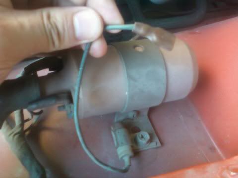

what is this thing?

First picture. Red Manifold vacuum lines. One used to go to dizzy vacuum advance, but now since these carbs are different, the vacuum signal there is not useful. Green holes. if there are connected to the manifold, plug them!
Second picture, Big one of valve cover needs to go to the the air cleaner. Many people put a little k&N filter on it. Other nipples, ignore!
Third picture. That is the crank case vent and needs to have a PCV valve on the end, connected to the intake manifold so it has soemthing to suck on to, well, vent the crank case!
Forth picture green. The two ports look like bowl vents but I'm not a DGV guy. They need to be connected to the atmosphere. Again, should go to the air cleaner.
Fifth picture: No clue. Someone? What else in the thermo/dizzy harness?
sixth picture. That "thing" is a condensor. Connects to + side of the coil. Designed to keep ignition noise out of the radio. If your radio is quiet, ignore it.
