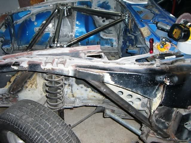

RB30X Posted September 2, 2010 Share Posted September 2, 2010 What are these braces called and is there any info on what they are made from or where they should be installed? Thanks Quote Link to comment Share on other sites More sharing options...
Dan Juday Posted September 2, 2010 Share Posted September 2, 2010 What are these braces called ... Overkill bars? Ballast? I'm not sure what problem they're solving. That is the first time I've seen a brace placed there. Maybe that is an area that needs stabilizing but unless it's tied into a comprehensive cage, I don't think there is much of a benefit. Quote Link to comment Share on other sites More sharing options...
ZR8ED Posted September 2, 2010 Share Posted September 2, 2010 (edited) I've seen them before, but on their own serve little real pupose. Coupled with a fully designed cage maybe. They link into the rocker panel (looks like it in this pic) We need a cage builder to chime in here to explain if it is useful or not. Assume on a street car they are worthless. Edited September 2, 2010 by ZR8ED Quote Link to comment Share on other sites More sharing options...
johnc Posted September 2, 2010 Share Posted September 2, 2010 What are these braces called and is there any info on what they are made from or where they should be installed? The braces are called... braces. All are custom made out of DOM tubing that look to be from 1 1/4 to 1 1/2" OD. Don't know about the wall thinness (my ex-ray vision is weak in the morning). And they look like they should be installed exactly where they are installed. Quote Link to comment Share on other sites More sharing options...

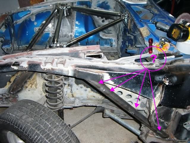

Administrators BRAAP Posted September 2, 2010 Administrators Share Posted September 2, 2010 You mean this brace under the fender that triangulates the rocker "panel-firewall-upper strut tower" in the vertical plane? As johnc mentioned, just braces for chassis stiffening/reinforcement, not really a particular name that I am aware for that particular brace. Quote Link to comment Share on other sites More sharing options...
johnc Posted September 2, 2010 Share Posted September 2, 2010 As johnc mentioned, just braces for chassis stiffening/reinforcement, not really a particular name that I am aware for that particular brace. Its called Tony. Quote Link to comment Share on other sites More sharing options...
RB30X Posted September 2, 2010 Author Share Posted September 2, 2010 I seen a few people use this method as a sutle way of strengthening the chasis without going a full cage. I've got an LS1 in my 240z and I don't want it to snap in half the first time I drop the clutch at the strip with some sticky rubber under the rear. Quote Link to comment Share on other sites More sharing options...
