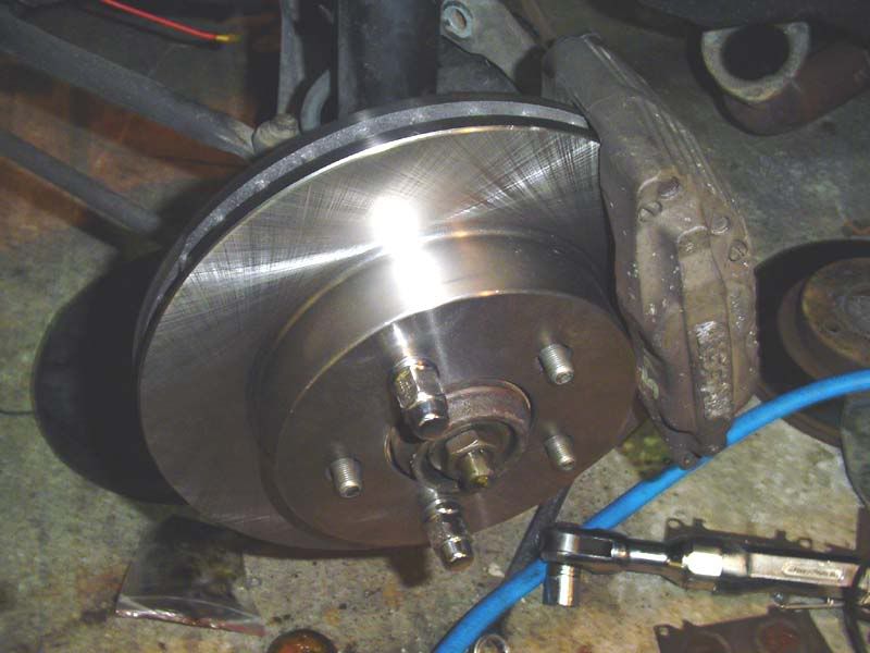

djz Posted September 11, 2010 Share Posted September 11, 2010 The rear is really easy, unbolt the S130 brakes and stub axles, remove the wheel bearings. Fit the Z31 bearings & spacer, stub axle and brakes, use the Z31 half shafts if you want, they are stronger. I did have to space out the calipers a couple of mm on my setup but I used the earlier non vented Z31 stuff. My front set up is using Z31 hubs, HR31 Skyline struts (similar to the Z31 struts but they bolt straight up), R32 calipers (same as some Z32) and AU Ford Falcon rotors, these are the parts that were available in NZ when I did the conversion. Quote Link to comment Share on other sites More sharing options...

djz Posted June 25, 2011 Share Posted June 25, 2011 Can't seem to edit my previous post to fix the links so I'll post them again. I didn't use S130 struts as I wanted to use calipers with 100mm bolt spacing without adaptors so I used HR31 Skyline struts. There is no pressing involved when changing the front hubs, there is just a nut on the end of the stub that you undo then everything falls off. From what I can remember the inside diameters of the Z31 bearings are the same as the S130 bearings so the Z31 hubs will go straight onto S130 struts. The brakes I was using at the time were mixed and matched from what I could get hold of, I'm actually in the process of changing to S13 coilovers, S14 5 stud hubs and R32 GTR brakes. Quote Link to comment Share on other sites More sharing options...
