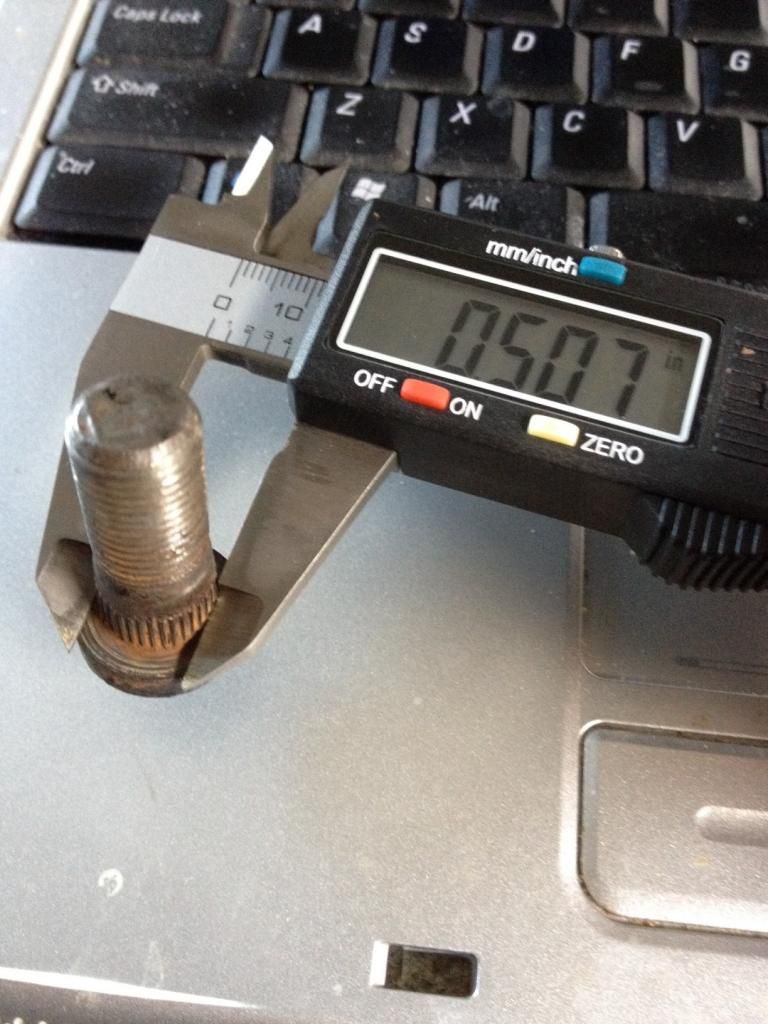

aongch Posted December 18, 2014 Share Posted December 18, 2014 (edited) If you don't mind a change in the thread pitch and obviously buying new lug nuts... Stock thread is M12x1.25. ARP has M12x1.5 with .509 knurl and 2.5" long The ARP 100-7708 Studs for a late model Camaro are what I have on the rear of my car and they work just fine. http://www.jegs.com/i/ARP/070/100-7708/10002/-1?CT=999 I'm about to install ARPs at least 2.5 in long, but obviously got the wrong knurl size, part 7716 fitting Subarus with .565 mm per some of the suggestions in these forums. ARP sells a 3 in. stud for a Subaru WRX that is the proper threads and they are way cheaper than the NISMO studs. I think they also have a shorter stud and one longer than the 3 in. ones I used. I'm running S30 280Z hubs front and stock rear stub axles I believe (Wilwood disc upgrade). The Subaru studs are definitely wider at the knurled end, does NOT fit. Will get a micrometer to confirm the old stud size. Measured oem 280Z stud knurled diam at .507". Does this mean the above GM 7708 (2.5" long) or 7713 (3.25" long) will fit? Edited December 19, 2014 by aongch Quote Link to comment Share on other sites More sharing options...
aongch Posted December 20, 2014 Share Posted December 20, 2014 (edited) The 'GM' extended studs 100-7713 fit perfectly, I suppose the hub I have is the 240Z version. Edited December 20, 2014 by aongch Quote Link to comment Share on other sites More sharing options...
