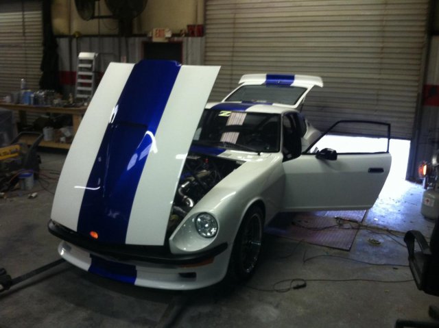

pat1 Posted January 11, 2011 Share Posted January 11, 2011 (edited) Hi guys I'm starting my 1jzgte swap on my 280z. I have made the cross member and installed the motor. now I'm going to make my motormounts and attach them to my crossmember today. Here is a couple pics Edited January 12, 2011 by pat1 Quote Link to comment Share on other sites More sharing options...

pat1 Posted February 5, 2011 Author Share Posted February 5, 2011 (edited) I been so busy building rear sump oil pans for the RB guys. I finally got some time to do my project I finished the motor mounts and welded them in. I welded 90 degree elbows to my intercooler and test fit the engine and trans. I also painter the engine bay. Here are some pics. Edited February 5, 2011 by pat1 Quote Link to comment Share on other sites More sharing options...

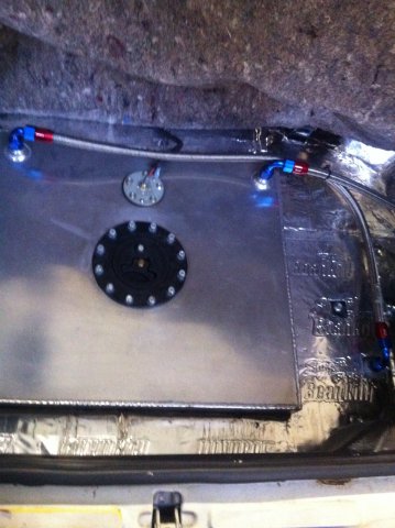

pat1 Posted February 19, 2011 Author Share Posted February 19, 2011 I got sometime today to work on my Z I picked up a different turbo a precision PT-61 I ran all my fuel lines from my fuel cell and installed a aeromotive fuel pressure regulator.I installed the engine and trans. Quote Link to comment Share on other sites More sharing options...
