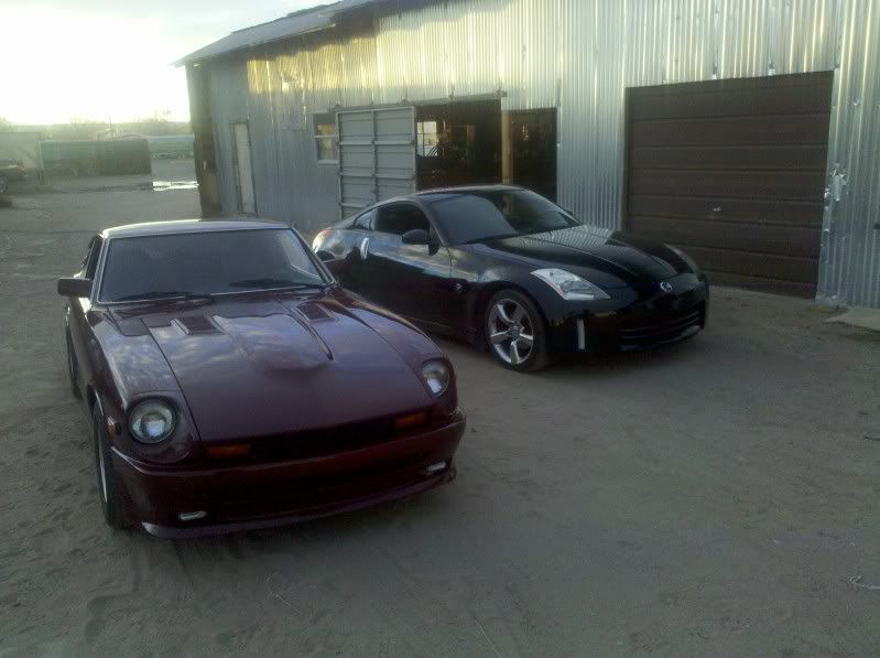

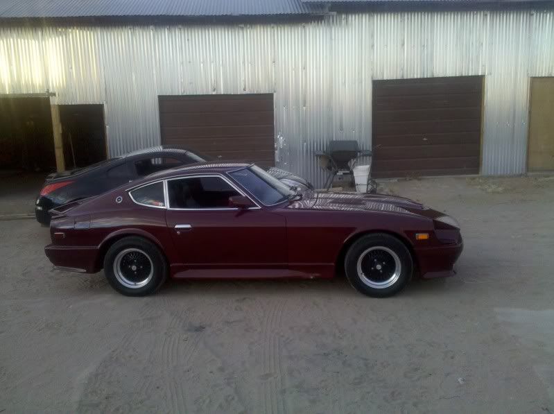

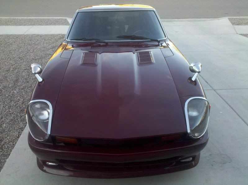

Hello everyone! This will be my 5th Z-car, 2nd S30. I swapped my 5.0 that I got bored with after 18 years of tinkering & modding in December. The Z has some fairly decent work done to it in the past year, to include paint, body, interior, but was mostly stock (Weber TB, CAI, Mallory ignition) albeit well maintained. In the past 2 months, I've swapped in Tokico springs & HP shocks, MSA ceramic coated header, 2 1/2" exhaust, stainless brake lines, and a Nardi steering wheel. I recently got some Brembo replacement rotors, Toyota 4-piston brakes with Porterfield pads, but got ripped off on the ZX master cylinder, so have to source another before installing the better brakes. I just bought an SR install setup from another friend's 240Z, with a Vildini engine cradle, trans mount (which I'll have to modify for my 280Z) custom driveshaft, and intercooler with piping, cut for the S30 body. I lucked into a cheap SR from one of my old room-mates, who just happened to have an extra he was looking to sell...but it'll sit in his garage until I get enough to pay it off (damn lack of money!).
Big things I still need to address is strengthening the chassis (frame rails have a bit of rust...) so I'll be getting some Bad Dog rails in the future & also stitch/seam weld reinforcing the entire body, to include the shock towers. Not my first time with that...my old 240SX must have had 200 pounds of reinforcement for it's 600hp setup! I'm going to slowly work towards ~350hp. My plans are a GT2871R, 256 cams, 740cc injectors, Z32 mafs, Power FC, & Greddy Intake...with standard supporting mods. One of my old S13's had that setup & it was a great streetable combo, which was very responsive. Anyways, here are a few (cell phone) pics...
I will probably be looking at replacing all the factory gauges with something that gives better visibility (DEFI or maybe whiteface style) to go along with the new setup...which will remain mostly stock as I work out the little issues & ensure it's sufficiently reliable for my tastes. I had planned on going with a Toyota JZ setup, but with gas prices going out of control & the great deals I fell into...I had to change my plans!
