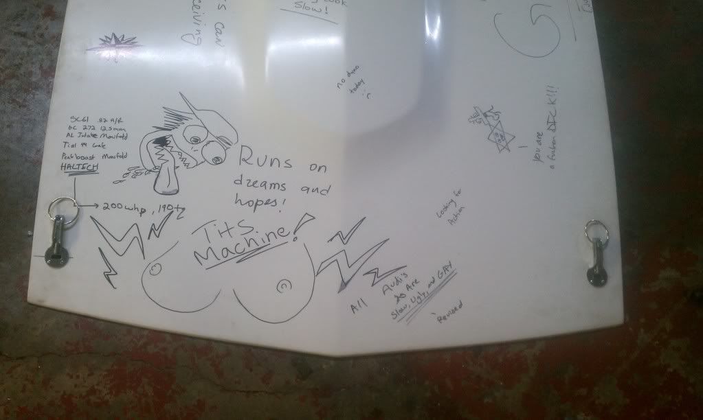

mr jdm Posted April 25, 2011 Author Share Posted April 25, 2011 My hood has way to much movement while driving. Maybe its my hood pin placement. What do you think where I put the pins are they too close to the corners? Enjoy the art work Quote Link to comment Share on other sites More sharing options...

mr jdm Posted April 25, 2011 Author Share Posted April 25, 2011 I'm trying to find out if my pins are in a good location I don't want to start another thread for it up get pics underside later its just flat with a an x brace underneath Quote Link to comment Share on other sites More sharing options...

johnc Posted April 25, 2011 Share Posted April 25, 2011 Where you placed the pins is fine and is where I've placed them on my cars and my customer cars. I think the issue is the hood isn't stiff enough. I had that problem with my earliest FG hoods and I had to upgrade to a Divinycell foam core (http://www.diabgroup.com/europe/products/e_prods_2.html) to keep the hood stable at speeds up to 120mph. At speeds over that the core needed a further upgrade to Nomex honeycomb. Adding an OEM style inner frame solves the problem at pretty much any speed up to about 150. Quote Link to comment Share on other sites More sharing options...
