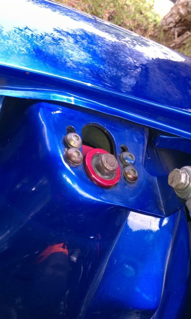

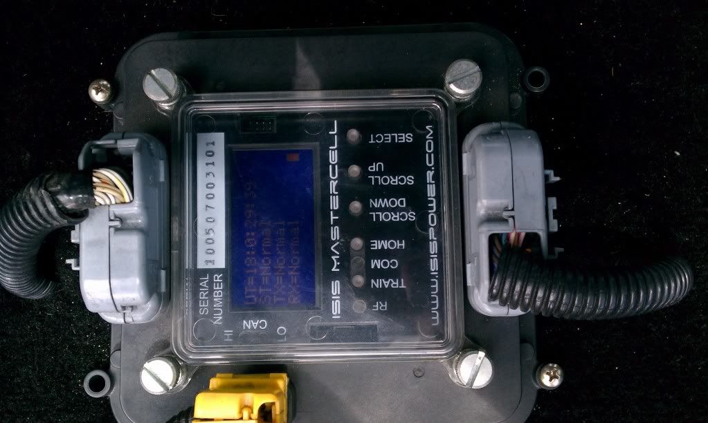

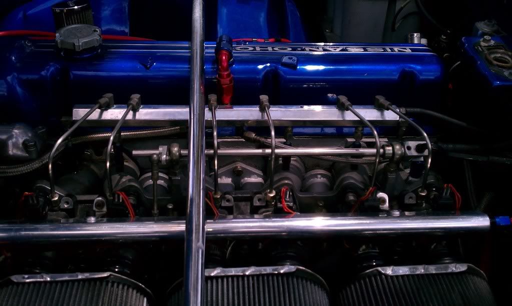

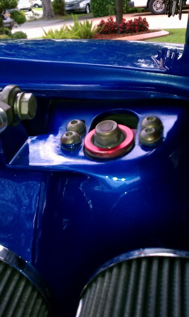

cpexcel Posted May 3, 2011 Author Share Posted May 3, 2011 (edited) Snap shot of Nos and vac rail, dual tap bar. Fuel rail to itbs...Isis Power System and Strut Towers. Edited May 3, 2011 by cpexcel Quote Link to comment Share on other sites More sharing options...

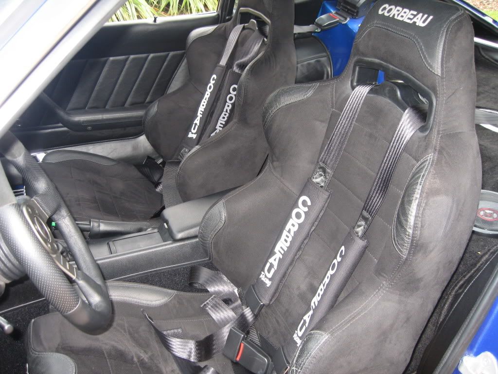

boyracer Posted June 17, 2011 Share Posted June 17, 2011 Great job! Did you mount the seats (LG1's?) to the stock points or did you fab up some new mounts? Do they hit your door panels at all? I was thinking about getting that suede material, is it comfortable and do you think it would wear well? Quote Link to comment Share on other sites More sharing options...
cpexcel Posted June 17, 2011 Author Share Posted June 17, 2011 Great job! Did you mount the seats (LG1's?) to the stock points or did you fab up some new mounts? Do they hit your door panels at all? I was thinking about getting that suede material, is it comfortable and do you think it would wear well? I have had them now for two years and they do wear well, they are also very comfortable. I'm not very big, so I slide right into them...The manufacturer sells the rail, the part number for my 78-280Z was D212T, I believe for your 240z the part number changes to C22011. I don't have the pictures to show you but, we cut out the brackets from the original rails and welded them to the new seat rails. I have about 3/4" clearance on the top of the seat from the door panel and around 3/8" from the lower section to the arm rest at the closest points. Hope that helps you. Quote Link to comment Share on other sites More sharing options...
boyracer Posted June 19, 2011 Share Posted June 19, 2011 I have had them now for two years and they do wear well, they are also very comfortable. I'm not very big, so I slide right into them...The manufacturer sells the rail, the part number for my 78-280Z was D212T, I believe for your 240z the part number changes to C22011. I don't have the pictures to show you but, we cut out the brackets from the original rails and welded them to the new seat rails. I have about 3/4" clearance on the top of the seat from the door panel and around 3/8" from the lower section to the arm rest at the closest points. Hope that helps you. That's great, thanks Carlos. From what I have found, a lot of ppl modify the mounts to gain more headroom. I am glad to hear that there is door clearance as this would be much harder to fix. Quote Link to comment Share on other sites More sharing options...
