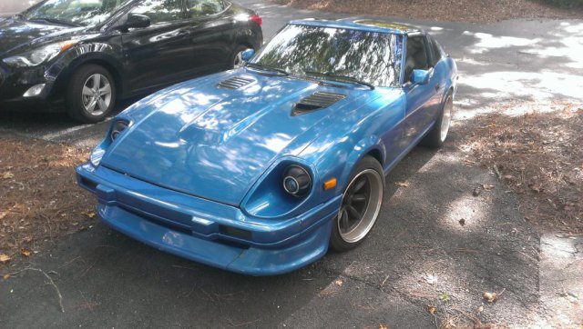

This project is coming along pretty nicely. Those do look good, but they look like they are just too open for me. I also think a headlight cover would make them look amazing. HID bulb choice for me is always near the 5k mark, suppose to be the brightest and most white bulb you can get.
5k is what I was thinking, I havent done much research recently, mind has been on other things.  I appreciate the complements, but I can't take all the credit.  The previous owner got the car where it is.  I have a long ways to go though.  Even longer now, I just punctured a fuel line with a damn power drill while trying to patch a rust spot. Looks like Im going to have to find a way to get the car in the air and band it or something.

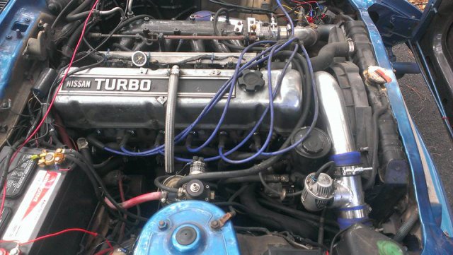

Even more issues...looks like my electrical gremlin never went away. I have two fuses that kept blowing, turns out they both went to the same wire, the wire is the one that connects to BAT on the alternator.  I was stuck in traffic and the more we slowed down, the worse the car acted.  Started stuttering horribly, loss of spark from what I could tell, finally some jack ass slammed on his brakes because the guy 800 feet ahead of him tapped his brakes, I stomped mine, car died and would not crank. Battery was completely dead. Im confused, this wire goes straight from the battery to the alternator, no stops anywhere between, so I guess my new alternator is bad... :icon51:
Well, last night while I was at work I had plenty of time to think about it.  The solution was not to replace the alternator, it was to not be an idiot.  The PO had glass tube fuses put on this terrible terminal strip thing, I replaced that with Maxi fuse blades and a little box, well, I used the same ratings he had used, the glass fuses were full of rust and hatred, they were all blown but passed current. The Maxi fuses are plastic and when they fail, they fail.  Long story short, he was using two 35 amp fuses in parallel for a connection that requires 1 80Amp fuse. (Running two fuses in parallel defeats the purpose of a fuse). so I replaced it with a rigged fusable link, car is running, battery is not dead. Why I did not figure that out the instant I discovered where that wire went, I will never know. Either way, I am off all next week, I ordered some stuff off Amazon and will be relocating my battery and cleaning up my engine bay, it needs it bad, removing wires that are just hanging and go no where and locating all my fuse boxes to where the battery was. If I can get everything I need I will be installing my MSD as well.

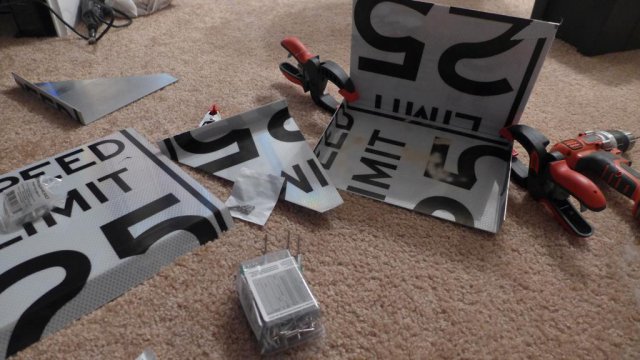

Well, some of my stuff did come in for doing my battery move/engine bay cleanup, but I cant get it done due to rain and lack of things I need to finish the job, one guy sent me the wrong part....pissed. I went ahead and built my "battery distribution center" that will sit in the place of my battery. As you can see, it was made with old speed limit signs, part of me wants to paint it, the other likes the way it looks...open to opinions.
Pieces layed out with my tools:

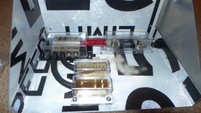

This is what it looks like inside, it will have my little fuse blocks  and lots of wire running through it when Im done.

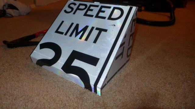

And this is with the lid on.  I still have not attached it, I dont know if I want to hinge it or fasten it with....something.
Im going to be putting it in the spare tire well on the passenger side.  I am running 0 gauge wire from the battery to the terminals under the hood, then 4 gauge to the starter.  The battery will have a 150Amp Circuit breaker mounted on it.  150A seems to be the norm to be able to start the car. I know a lot of people are probably going to be upset with the idea of moving the battery 50/50 weight distribution etc, but really, if I was worried about the 50lb gain in my hatch area I would lose 100lbs myself to make up for it.

I sold my T5 about 4 months ago . I'm using 400 amp. CB on both of mine . 150 amp. is close , most starters exceed that . Triple-pass rad. might be a little too much for OE water pump . Read somewhere that triple-pass requires high volume water pump .
