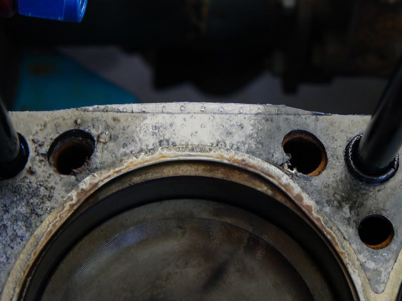

Whichever gasket you get (save for an MLS gasket), make sure the outline of the gasket on the manifold side follows the fire ring like this:
So that it can blow out the side like this:

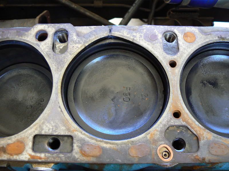

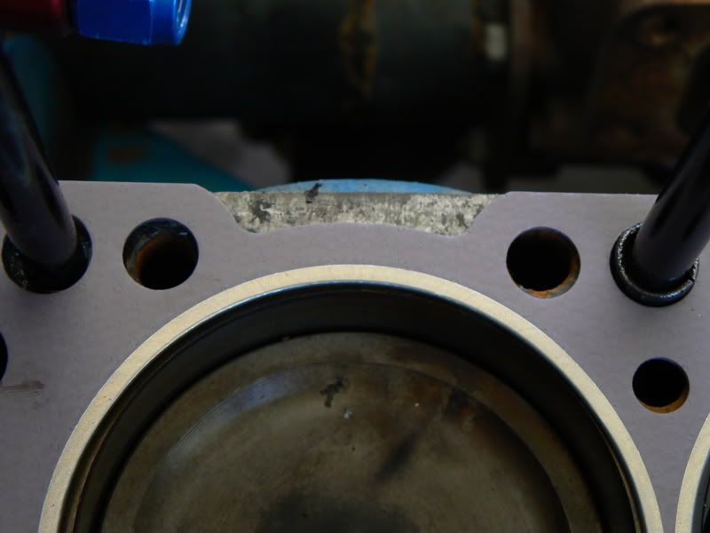

If the gasket just follows the side of the block like this:
Then when you have heavy pinging, it won't blow out the side to act as a safety fuse, it'll just let coolant in from the adjacent coolant passages like this:
(The first two pictures are of MSA gaskets, the last two are of a "Stone" gasket I got laying around at work.)
