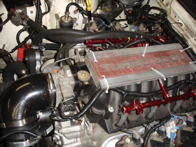

Posted 10 June 2011 - 08:26 PM
Posted Image
Needs some brackets made, but it stays.
