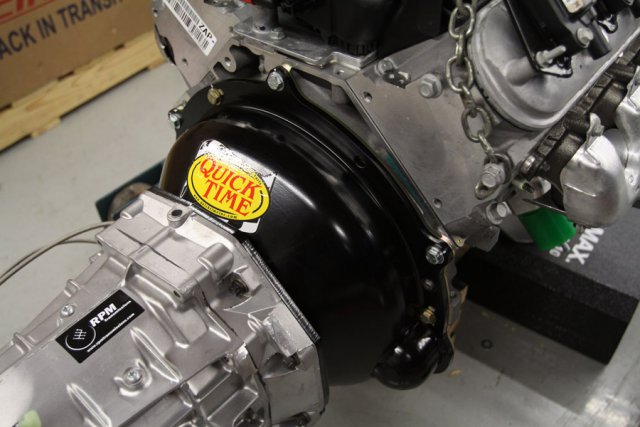

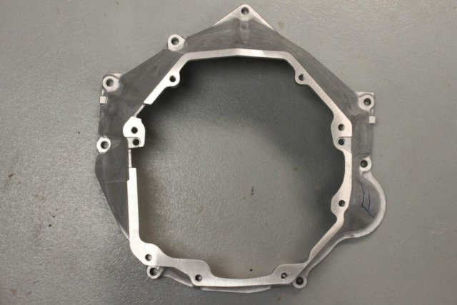

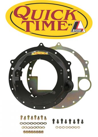

	^^^^THIS is very helpful! I had thought about keeping the VG Trans. This may make the swap much easier! Im not sure about their accessory belt drive yet i would really like to see some pictures. I may end up buy their adapter kit and getting a t56 just to weigh my options. I also had a thought... I know the trans tunnel is always an issue with a GM transmission. Especially right at the firewall. So i have been looking the the differences in clearance between the F-body and Quicktime Bellhousings. Here is a couple pics tho show what i am talking about. You can easily see how the quicktime doesnt have the slope like the F-body does. Which may, or may not help with some clearance.
