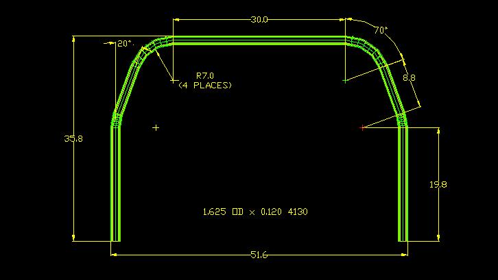

Main hoop dimensions
74_5.0L_Z
These are the dimension of my main hoop. I sent this drawing to the chassis shop and they bent it perfectly. This roll bar fits very tightly, and requires trimming the interior plastic.
Thank you for posting this. I used your picture to have a local cage builder bend my main hoop. Just for general info, mine was 1.75" diameter so the measurements had to be changed around a bit. Mine measures 51.3" across the bottom of the tubes and barely fits inside the rockers on my 70.
Link to comment
Jon I hope the dimensions were helpful, and that it fit like you'd hoped. I put these dimension out there because I felt that most peoples main hoops weren't tight enough to the pillar, and as we all know, "Tight is right".:) Dan
Link to comment
I used this at my local cage bender.. and asked for a 1.5" tubing.. they made adjustments and it fits perfect.
Thanks for sharing!!!
