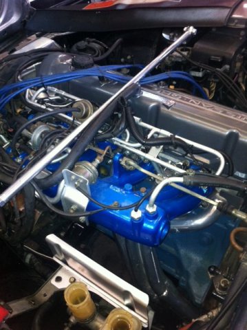

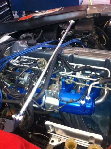

	I've rebuilt my engine for my daily driver '78 280Z after a lot of input from many, and lots of reading here. I decided on a N42 head (ports are gasket matched) on a N42 block with '75 intake and K&N induction, flattop pistons, .485/.270 reground OEM cam with Isky springs, triple grind valves and new Nissan rockers, Pacesetter 6-3-2 ceramic coated header, into a 2.5" MSA exhaust, all on stock EFI. The bottom end was refreshed with a polished crank and new crank bearings. It got a new oil sending unit, new timing chain kit, and new water pump. I've had the car back from the shop for 2 days and am pleased. I'm still 250 miles away from having it broken in - nothing over 3800 rpm, but it's running really well and no detectable detonation with 93 octane. After the break-in I'll change the oil and run up the rpms. I took the opportunity while the engine was out to repaint the engine bay, so everything came out. Good thing I did cuz I found a rusted/busted weld at the joint where the right inner fender and firewall come together, i.e. behind the battery. Had to weld in some metal from a donor, but it's strong now. I also had some key parts powdercoated at the same time - crossmember, engine mount metal, oil pan, intake, fuel rail, heat shield, timing cover, and of course the valve cover. I added a front strut tower brace and was surprized at the difference that made, so I'll add the rear one later. There are a few aesthetic changes to be done, but I'm almost there.
