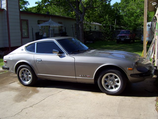

Well, I owe you all an update. I'm toward the end of break-in. Lot's of time was spent getting the inside fender/firewall welded up correctly and I also had some problems with the cam (not my fault or cost), so another had to be reground, along with lash pads. I end up with 10.3:1 compression (no detonation detected on 93 octane) with stock EFI so far, Stage 2 cam w/triple ground valves and Isky springs, 6-3-2 header, 2.5" exhaust. Man does she run now! It was already lowered with Eibach progressive springs and KYB struts, and has Brembo rotors/Toyota calipers w/ceramic pads. Interior is done stock except steering wheel and stereo. I did replace the headlight long ago, but now the other has a rock ding. Next will be some sheet metal work done on the floorpans, though it's been fiberglassed and is dry for the time being. Front airdam and rear spoiler needed. And I've got to get rid of those bumpers!

I've rebuilt my engine for my daily driver '78 280Z after a lot of input from many, and lots of reading here. I decided on a N42 head (ports are gasket matched) on a N42 block with '75 intake and K&N induction, flattop pistons, .485/.270 reground OEM cam with Isky springs, triple grind valves and new Nissan rockers, Pacesetter 6-3-2 ceramic coated header, into a 2.5" MSA exhaust, all on stock EFI. The bottom end was refreshed with a polished crank and new crank bearings. It got a new oil sending unit, new timing chain kit, and new water pump. I've had the car back from the shop for 2 days and am pleased. I'm still 250 miles away from having it broken in - nothing over 3800 rpm, but it's running really well and no detectable detonation with 93 octane. After the break-in I'll change the oil and run up the rpms. I took the opportunity while the engine was out to repaint the engine bay, so everything came out. Good thing I did cuz I found a rusted/busted weld at the joint where the right inner fender and firewall come together, i.e. behind the battery. Had to weld in some metal from a donor, but it's strong now. I also had some key parts powdercoated at the same time - crossmember, engine mount metal, oil pan, intake, fuel rail, heat shield, timing cover, and of course the valve cover. I added a front strut tower brace and was surprized at the difference that made, so I'll add the rear one later. There are a few aesthetic changes to be done, but I'm almost there.

Long time coming, but an update is in order. I upgraded the calipers to 4-piston. I also lowered the car by 1.5", and put 15" Koenig Rewinds on it. I've rebuilt (but not installed) the engine with flattop pistons using a N42 head that has had light gasket matching porting done. Also upgraded the cam (comes in today) to a .480 lift/.270 duration, of course with new rocker arms, lash pads and springs. Polished crank with new bearings. New timing chain and tensioner. New oil pump and water pump. It'll get the ceramic coated Pacesetter 3-2 headers and a 2.5" exhaust with high-flow muffler. I also sourced an N42 intake with the open runners so one can see the headers underneath. While the engine was out we removed all engine bay parts, did some welding under the battery tray, and painted black. New motor mounts. Crossmember, valve cover, fuel rail, and oil pan powder-coated. Front bumper comes off too. All comes together in next 2 - 3 weeks. Can't wait.
