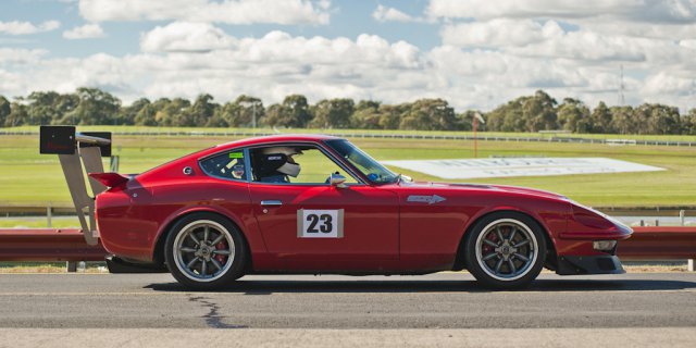

  1. Here is a pic of my car at the Phillip Island race circuit in Australia. I was competing in a Super Sprint.
  2. Yes, it's a custom one, had it made by Alfa Motorsport Fibreglass in Australia. http://www.motorsportfibreglass.com.au/contact-us.php

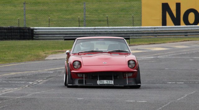

  3. Finally finished all the aero mods, splitter, bonnet, rear wing and head light covers.

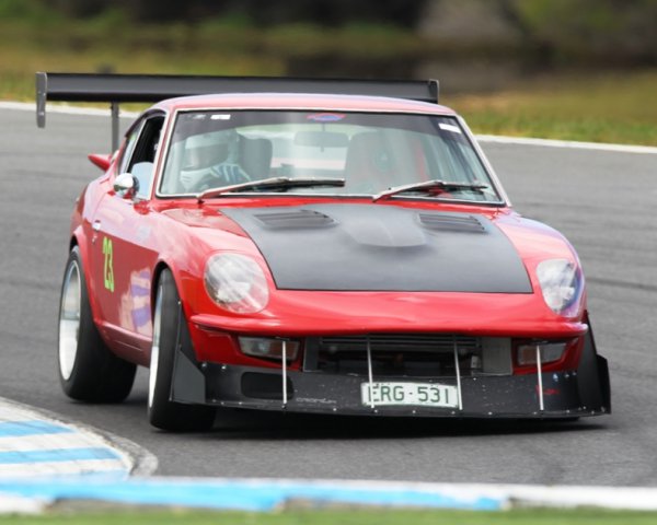

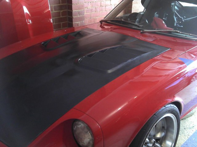

  4. Fire604, I only really drive the car on nice days or to the track, so water really isn't a concern. Nelsonian, The guys that made the bonnet can supply the vents only if required, they are in Australia see here. http://www.motorsportfibreglass.com.au/

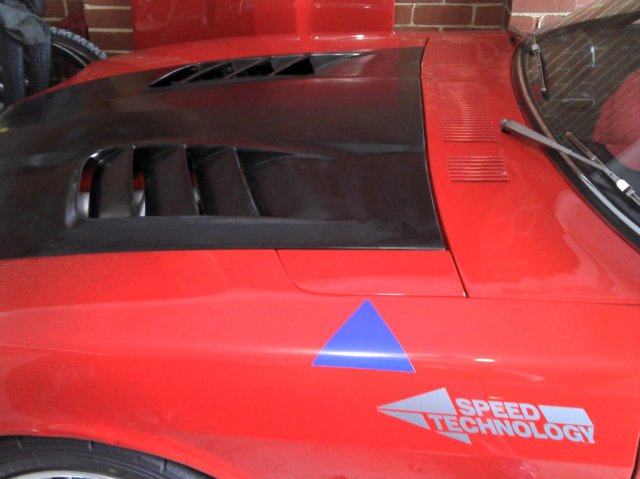

  5. Thought I should share my new fibreglass bonnet (or hood as you guys call it) and big vents which I think will reduce under bonnet pressure.

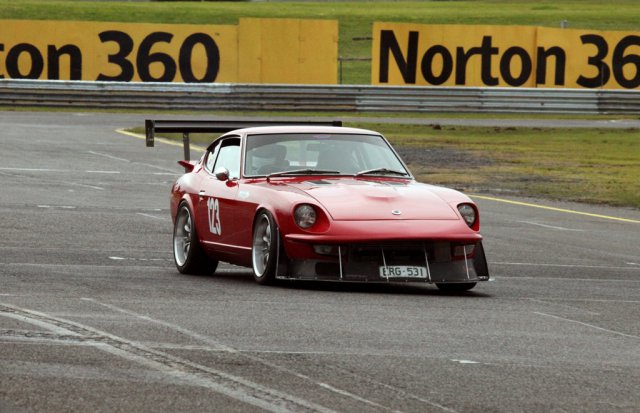

  6. Here is a pic of the new front splitter and finished rear wing. Both turned out to be very effective.
  7. No the front spoiler/splitter/diffuser doesn't come off for the street, which means I have to be careful about where I drive!

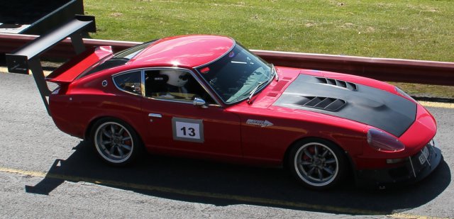

  8. Here is a pic of my Zed in race setup. Wing on the back is removed for street driving.
