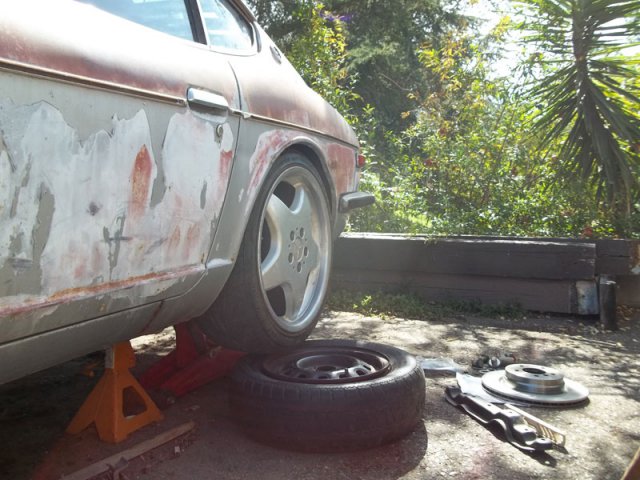

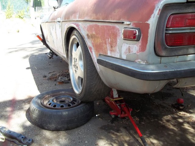

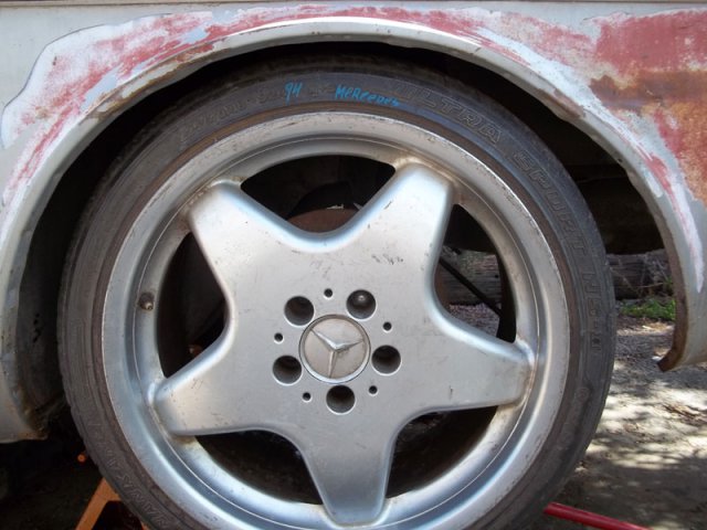

  1. I didn't realize that I had this old account and it's still me notheredave...I lost my password for the other account. Well I have changed my mind on these wheels and brakes for now (because I would have to flare the fenders and more) So I went back to the big 14" brakes and the Mercedes Benz 18"X8.5" rims with small 225's on them now. I put a half inch spacer on all 4's and went long ARP studs and had everything redrilled for the 112mm X 5 lug pattern. I checked the ground clearance which for now will be 5.5" (stock is 6.3") and when I need tires I will be putting 255/40R18's on there. The machine shop has been pushing the work for the last 3 weeks but claims that everything will be done next week...YEAH Also I am either going to polish these or powder coat...Have'nt decided yet.
